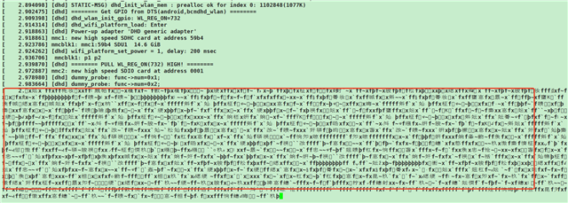

AM62L: linux(A53) using wkup_uart0 exception
Part Number: AM62L
Open wkup_uart0 in k3-am62l-wakeup.dtsi:
	target-module@2b300050 {
		compatible = "ti,sysc-omap2", "ti,sysc";
		reg = <0x00 0x2b300050 0x00 0x4>,
		      <0x00 0x2b300054 0x00 0x4>,
		      <0x00 0x2b300058 0x00 0x4>;
		reg-names = "rev", "sysc", "syss";
		ti,sysc-mask = <(SYSC_OMAP2_ENAWAKEUP |
				 SYSC_OMAP2_SOFTRESET |
				 SYSC_OMAP2_AUTOIDLE)>;
		ti,sysc-sidle = <SYSC_IDLE_FORCE>,
				<SYSC_IDLE_NO>,
				<SYSC_IDLE_SMART>,
				<SYSC_IDLE_SMART_WKUP>;
		ti,syss-mask = <1>;
		ti,no-reset-on-init;
		power-domains = <&scmi_pds 83>;
		clocks = <&scmi_clk 324>;
		clock-names = "fck";
		#address-cells = <1>;
		#size-cells = <1>;
		ranges = <0x0 0x00 0x2b300000 0x100000>;
		status = "okay";
		wkup_uart0: serial@0 {
			compatible = "ti,am64-uart", "ti,am654-uart";
			reg = <0x0 0x100>;
			interrupts = <GIC_SPI 108 IRQ_TYPE_LEVEL_HIGH>;
			assigned-clocks = <&scmi_clk 324>;
			assigned-clock-rates = <48000000>;
			status = "okay";
Then configure wkup_uart0 in dts:
 &pmx0 {
+       wkup_uart0_pins_default: wkup-uart0-default-pins {
+               pinctrl-single,pins = <
+                       AM62LX_IOPAD(0x0008, PIN_INPUT, 0) /* (W23) WKUP_UART0_CTSn */
+                       AM62LX_IOPAD(0x000c, PIN_OUTPUT, 0) /* (W22) WKUP_UART0_RTSn */
+                       AM62LX_IOPAD(0x0000, PIN_INPUT, 0) /* (Y22) WKUP_UART0_RXD */
+                       AM62LX_IOPAD(0x0004, PIN_OUTPUT, 0) /* (AA23) WKUP_UART0_TXD */
+               bootph-all;
        main_uart0_pins_default: main-uart0-default-pins {
                        AM62LX_IOPAD(0x01b4, PIN_INPUT, 0)      /* (D13) UART0_RXD */
@@ -461,6 +485,14 @@ AM62PX_IOPAD(0x0188, PIN_INPUT, 0) /* (A9) MCASP0_AXR1 */
+&wkup_uart0 {
+       pinctrl-names = "default";
+       pinctrl-0 = <&wkup_uart0_pins_default>;
+       status = "okay";
+       bootph-all;
Changing only these, the startup appears garbled and I can't access the file system, is this an error in my configuration? Please help to check.

[    2.󿖘x妘x`ffxff枆妆򜗦xxff𝥦䖘帞fx򄘘𙞘~x嶘fxf~`f斆~fþx嶘fþx󿧦񹽦󿥦~`þx綆xffx𖞆xf׾f~`fݦx~þ`ffxþ󦄘fx柾xf󾆞f󿦆񹦀fx䖞䖞`~x`ff~xfþf~x朘fþf񷡦f松fxþ󾘆򝥦xxþ񦅾x緦xffx斞ٸ׾x`ff~xfþf~x朘fþf󿥾妆fff彦xf~fx񶝦x񞆘֞fx䖘x~x`ffþþþþþþþþf񶗸f~f瞆~þ𗿾xf~f瞆~`þ󿦆񶄘þþþþþþþþfx𘙠~~x`ff᧠fxþf񷽦~f񼙸fx~f~f򙞆f`xfxfxffx𞗸~xx~x`ff᧠fxþf񹦞朞妆򜗦x`fxff晠fx𜖞x斞~~x`ff᧠fxþf񹦞朞妆򜗦x`fxff䗸怘fx𞙦晸~x`ff󿥾ffþ~xf䗸Ƙ򟾞`ff 矦f晠󿤆緦x怘fx𜖞晠妘x`ffxþf`x~f򘘆x枘``xff򜜆x~f𙦀fx𜖘f~x`fffff斞f`x`奾܆þffx柾f񶄆߾~񶜆~þ򗹠򞗦x׸xx怘fx𞙸f~x`ff񼟦󿥸fx~þ߾񼄆~󿥾xffx񞘘x晦~x`fffff斞f`x`奾܆þffx柾f񶄆߾~񶜆~þ𖟠򞗦xfx񠙠f٠~x`ff񸆞þþf~`f瞆񷞆񹽦xf󾆞þ 秦򞗦xxf怘fx񞗸x򝦘~x`ff񸆞þþf~`f瞆񸙠þ礆彦þ䖘fx񠗸~󷸘~x`ffx`綆xþþf򜗦x~þf~`fxf`ffx񞖞x򞀘~x`ffx`綆xþþf򜗦x~񷞆f~`fxþ祦fx񠙦׸妘x`ff`򝾆~f񶙸fxxfþf䗸ffx񠖞x妘x`ff`򝾆~f񸘘Ƙ򜝦`ffxf󾆞~f񷸆~f秦xx怘fx񞖘妘x`ff``~xþ񼆞f񦞘򞗦x綆񷞆~þٸxþf~ٸx~f򖖘fx񠙸򜖞妘x`fffff斞f`x`奾܆þffx柾f񶄆߾~񶜆~þ򖟠򞗦x󾗸fx񦙠xxx~x`ffx`姠柸x姸fx`姠񷶆~xf~`fffŸƘ󾆞ff󾆞񷷦򞘀fx񤗸~󶆘~x`fffff斞f`x`奾܆þffx柾f񶄆߾~񶜆~þ𖘆򞗦x󾘘xfx񤖞斞妘x`ffx`妘朞~߾f`󥦞þfxf`f񦝦~f𘝦~xf~þf򝶆þffff~~þfffffx񤖞׾x`ff`~x؞斘f~߾f繦fxܞ姸f~朘~fx~`֞fþ`f񼇦~fxƘ󶆘xfx񦖞x~x`fffff斞f`x`奾܆þffx柾f񶄆߾~񶜆~þ򙤘򞗦xf旸xfx񦙸󾖘~x`ff`~x؞斘f~߾f繦fxܞ姸f~朘~fx~`֞fþ`f񼇦~fxƘ󶆘ٸfx񶖘~斞妘x`fffff斞f`x`奾܆þffx柾f񶄆߾~񶜆~þ򙠘晸ffxffx񶗸妘x`ffx`妀~`f瞆~fxxx`奾~`松奾fxxþf񸆞þ晸񼆆񽤆x怘fx񸗸`𙦘~x`ffx`妀~`f瞆~fxxx`奸硦f񸆞þ昀񼆆񽤆x怘fx񶖞x旾x`ffx`妀~`f瞆~fxxx`姸xþf񸆞þ䙠񼆆񽤆x怘fx񸙦x~妘x`ffx`奸fxf󷥸`奾þ秦f`~~þ礆󿥾ff~f`ffx`ffx񸖞xx׾x`ffx`奾f硦祦񼆆񶟦񧷦x`~ff恦f~񶟦򘟦`fx杠fxx怘fx񶖘`xf~x`ffx`奾f硦祦񼆆񶟦񧷦x`~ff恦夘x晾ffffffff`f夘x晾fffffffx񼖘x~x`ff񸆞þþf󿦞姸fxxxf姠f夆~朆~ff矦fx񾙠󷞘~x`fffff斞f`x`奾܆þffx柾f񶄆߾~񶜆~þ򙞘򞗦x󾘘xfx񾗸x~x`fffff斞f`x`奾܆þffx柾f񶄆߾~񶜆~þ𗹠򞗦xf旸xfx񼖞~󾖘~x`ffx`綆xþþf򜗦xþf`~f祦񼄘``妀ffff`þ~f怘fx񾙦󾖞~~x`ff`þ񼆞fþ~`fxfx~f󷦞þ򙞘󾘆f񞘆䘆`xfx慦ffxfx񾙦󾖞~~杦x慠f秦f懠柾fxxپf`þ`fxþf~ݠ愆󥹾慠ff`fxxff~ݠf~硦~朘祦񷡦fxxހff~柾f򝤆愞杦󟥸þ`򝷦x繦񤅾þ~ffxݦ繦򄙦󿦞``ᦞ杦ݦx򖝦𗷸xxf~晸~`fx񾙦󾖞~~fx񾘘𖞆~x`ff忠~~߾f~þf`妞瞆þf杠fx~恦ffx򀙠󷾘旾x`fffx~f~f򘘆`fxx矦x忠~f怆~񠅾~xx~xfx򀙠󷾘旾fx򀗸f󾖞x~x`ff忠~~߾f`򞆞`奾xfþfxx~xþf~xfþf󦙠xþ矦xþfxx晠fx񾖞x~妘x`ffx`姠f~奸f~fxfx`~þþf~fxx`þþfx򀙦x~x`ffx`姠f~姸~þ~f祦񼄘``妀ffff`þ~f怘fx񾖞~x`ffx`姠f~奸f~fxfx`~f祦񼄘x`f~䄆`fffx򀖞x~x`ffx`奾幠þ柾f󾆞f~󾆞ffx񾘘~񸗾x`ffx`姠f~奸f~fxfx`~f祦񼄘``妀ffff`þ~f怘fx򀙸xf妘x`ff~xfþf~x朘fþf񷡦f松fxþxff~󾖘緦xffx򄘘򖞘~x`ffþþþþþþþþffؘfپff`~妘žxþ~fþþþþþþþþfx򆗸䘘~x`ff~xfþf~x朘fþf񷡦f松fxþ򝥦xxþ񦅾󾖘緦xffx򄖞fٸ妘x`ff忠~~߾f`򞆞`奾xfþfxx~f~怘fx򆙦x~~x`ff~߾f`򞆞`姦~þf`~fx򄖞󶆘~x`ffx`綆xþþf򜗦x~f~`fx綆񹠞ff緦x`怘fx򆖞x~᧠fxþf񹦞朞fx󾗾~򜗦x~`xfxfx᧠fxþf񹦞朞xfݦx~`󹦞٠fx򄘘򖗸妘x`fffx`妞杠f~ݦ妘`~f`󷤘fx򆙸x妘fxf~fx~f𖖞x񠗾þ򝦆`矦񶜆xþf`怘f񞘘xxx~ff`x柦󾆞x񶟦xfxfᦞ朆f~fff񠙠󼆘ff`x柦󾆞x杦`fx`xݦ緦綆~ffxf󾅸x`󿥦`x᥸xxx`fx򅼆~`xf񷞆x~杠fx򗟦~þ`f杠fxþ񦆆怘f񞖞x~fx昆~杦`fx`򟾞`f~`xݦ緦綆~ff𗷦~fx֞~怘f񠙦x夘xf~`fx~杦`fx`ff񞖞x~`fxff񼆘憞f緦x`奸ffx柾f~xxff񠖞晸x夘f~򘄞󿦞󾆆򆝠綆`򜝦x緦f򆙦xx~󧶆~ff`杦~~f綆~ff~杦󿥸x朘fx󿥾ݠ~杦xxff񼆘󾆞þ禆怘f䘆`~fffx~f~f񷞆f`þfffx򝡦柠xfކff䘆䖞xx~fx~ff`杦~񼆘~`f~xf䘆`妘愞f`f~fþf~`f~xf䘆x𗼆󧶆~ff`杦~~󧶆~ff`xf䘆𙷦~󸞆񼆘󧶆~ff杠fxffff`f`ff`؆󥥦fffþff斆f恦ff恦晦f`ffff`󥥦֞ffff徆f`fffxff`ff``斘`򖘘`𘞘fff晾`怆ffffffffff؆``ffff`fffff`fxf٠f`f`f`򟦘`f`ffxffxfffff`f`þf`fff姾ff恦晦þ𗥦ff旦ffx昆f无fxfxf~ݠff򇹦󾆞f憞xffx怘f䘆`~󧶆~ff`杦~~`f~f瞆~fx󞆞`fx~f񸘀򝶘󦀘怘~f柦f~þf؞f󥹾xxf֞ff恦f䘆ٸ晦󼆘󧶆~ff`杦þ
  • Hi Mazel,
    To fix this problem, please remove the line "assigned-clock-rates = <48000000>;" from wkup_uart0 node in k3-am62l-wakeup.dtsi.
    diff --git a/arch/arm64/boot/dts/ti/k3-am62l-wakeup.dtsi b/arch/arm64/boot/dts/ti/k3-am62l-wakeup.dtsi
    index e39fa3cd7ff2..72e7516208bd 100644
    --- a/arch/arm64/boot/dts/ti/k3-am62l-wakeup.dtsi
    +++ b/arch/arm64/boot/dts/ti/k3-am62l-wakeup.dtsi
    @@ -107,7 +107,6 @@ wkup_uart0: serial@0 {
    -                       assigned-clock-rates = <48000000>;
                            status = "disabled";
