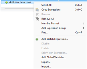

  • Hi Patrick. I also have this same issue, so maybe I can add some info.
    For CCS Eclipse... I first saw a reference to this feature in the universal motor control lab (section 3.1.5.2 Setup Debug Environment Windows).
    Sure enough -- if you right click in the Expressions window in CCS 12, you can select "import" or "export" as your options.

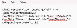

    The expressions text file internally (I just did a test export) is basically an XML file that looks like this:
    Also have not seen any way to import this into CCS 20 for debugging.
  • Hi Tyler,
    Thanks for the info, I wasn't able to see the two import/export context menu items until I started a debug session.
