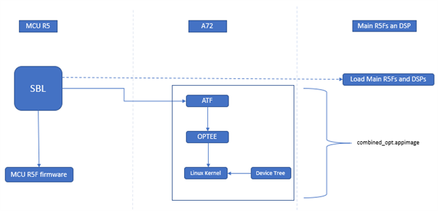

J784S4XEVM: Try to boot a HLOS+RTOS appimage using SBL
Part Number: J784S4XEVM
I'm using the J784S4 evaluation board and I'm trying to use this boot flow with MMCSD :
RTOS SDK: ti-processor-sdk-rtos-j784s4-evm-09_00_00_02.
What I did:
- make -s -j sbl_mmcsd_img_hlos BOARD=j784s4_evm
- copy boot/sbl/binary/j784s4_evm/mmcsd/bin/sbl_mmcsd_img_hlos_mcu1_0_release.tiimage to boot partition as tiboot3.bin
- copy drv/sciclient/soc/V6/tifs.bin to boot partition as tifs.bin
- copy boot/sbl/tools/combined_appimage/bin/j784s4_evm/combined_opt.appimage to boot partition as app
When I switch on the board, there is no output on UART8, MCU_UART0 or WKUP_UART0 ...
Have I done something wrong ?

    ************** Optimized Boot Flow **********
    Step 1:
    Download tisdk-default-image-<board_name>.wic.xz from the below links
    for j784s4 : http://lcpd.itg.ti.com/builds/arago-kirkstone/prod/j784s4-evm/latest/images/
    step 2:
    Flash the above image to the SD card using balena etcher too. You can download the same from https://www.balena.io/etcher/
    step 3:
    Remove all images from the boot partition of SD card using rm command
        Open terminal in boot partition of SD card
        sudo rm -rf *
    step 4:
    Insert SD card into the evm
    step 5:
    Build sbl_ospi_img_hlos_mcu1_0_release.tiimage by using the following command
    make BOARD=<board_name> sbl_ospi_img_hlos -sj
    step 6:
    Change the boot switch settings to UART bootmode.
    step 7:
    Flash uart flash programmer (below commands are suitable for linux PC)
        sudo <path to uniflash tool>/uniflash_8.0.0/dslite.sh --mode processors -c /dev/ttyUSB* -f <path to uniflash tool>/uniflash_8.0.0/processors/FlashWriter/<board_name>/uart_<board_name>_flash_programmer_release.tiimage -i 0
    step 8:
    Flash sbl_ospi_img_hlos_mcu1_0_release.tiimage at 0x0
        sudo <path to uniflash tool>/uniflash_8.0.0/dslite.sh --mode processors -c /dev/ttyUSB* -f <pdk install path>/pdk/packages/ti/boot/sbl/binary/<board_name>/ospi/bin/sbl_ospi_img_hlos_mcu1_0_release.tiimage -d 3 -o 0
    step 9:
    Flash tifs.bin at 0x80000
        for j784s4 : sudo <path to uniflash tool>/uniflash_8.0.0/dslite.sh --mode processors -c /dev/ttyUSB* -f <pdk install path>/pdk/packages/ti/drv/sciclient/soc/V6/tifs.bin -d 3 -o 80000
    step 10:
    Flash combined_opt.appimage at 0x100000
    sudo <path to uniflash tool>/uniflash_8.0.0/dslite.sh --mode processors -c /dev/ttyUSB* -f <pdk install path>/pdk/packages/ti/boot/sbl/tools/combined_appimage/bin/<board_name>/combined_opt.appimage -d 3 -o 100000

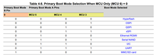

  • I agree with the SD CARD bootmode pins.
    I do not understand the OSPI bootmode pins. Here's how I understand this:
    MCU_BOOTMODE Meaning Bit BOOTMODE Meaning Bit
    MCU.9 SW7.8 POST x MAIN.7 SW11.8 BACK BOOT MODE CONFIG
    MCU.8 SW7.7 POST x MAIN.6 SW11.7 PRIMARY BOOT MODE CONFIG 0
    MCU.7 SW7.6 0 MAIN.5 SW11.6 PRIMARY BOOT MODE CONFIG
    MCU.6 SW7.5 MCU-only 0 MAIN.4 SW11.5 PRIMARY BOOT MODE CONFIG CS {0,1}
    MCU.5 SW7.4 PRIMARY BOOT MODE A 0 MAIN.3 SW11.4 BACK BOOT MODE
    MCU.4 SW7.3 PRIMARY BOOT MODE A 0 MAIN.2 SW11.3 BACK BOOT MODE
    MCU.3 SW7.2 PRIMARY BOOT MODE A 1 MAIN.1 SW11.2 BACK BOOT MODE
    MCU.2 SW7.1 REF CLK (19.2 MHz) 0 MAIN.0 SW11.1 PRIMARY BOOT MODE B 0
    MCU.1 REFCLK 0
    MCU.0 REF CLK 0
    Arbitrarily assigning POST to 00, I'd expect SW7[1-8] = 0100_0000
    and setting the BACKUP MODE and CONFIG to 0 (matching what you have), I'd expect SW11[1-8] = 0000_0000. I agree that SW2.1 = 0
    Certainly, I could be making a mistake here, and this is why I have but so many explicit columns in the table. Can you see if the change in BOOTMODE settings effects your OSPI results?
    Kevin
  • I tried SW7[1-8] = 0100_0000 SW11[1-8] = 0000_0000 and SW2.1 = 0 => not more successful.
