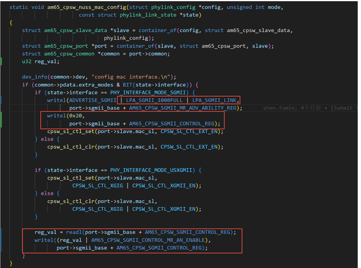

We have a TDA4VEN project that requires the use of dual network cards. We have installed an Rtl8211FS network card with SGMII interface on SerDes1.
The configuration of this DTS cannot load the phy driver of SGMII's RLK8211fs properly. May I ask how to configure it
thank you.

  • hi,
    How to change the PHY attribute of CPSW port 2 (cpsw3g_phy1) mentioned to realtek. c (rtl8211fs)
    (cpsw3g_phy1) The PHY hardware address is 1.
    The RTL8211FS driver supports SGMII.
    May I ask how to link the driver to/driver/net/py/realtek. c PHY-ID-MATCH_EXACT (0x001cc916)?
    thanks!
    If you want to enable any specific configuration supported from PHY driver then you need to use under MAC Port.
    Address 1 mapping is sufficient, to link MDIO to PHY for read/write operations.
    The linking of PHY driver is not manual or configuration from device tree.
    Linux PHY will check the device ID of PHY by reading phy registers and map to the driver exist in kernel with matching IDs. If no driver exist it will map to generic phy driver in Linux.
    Please check with PHY vendor, if phy driver is not linked to your PHY.
    Sudheer

    From log it seems like eth1 Linked up at 100Mbps.
    Can you please check the Pins configured for Ethernet Functionality or not? (I mean SerDes Lane CTRL register).
    Sudheer
  • hi,
    ************cpsw***************
    //cpsw3_CPSGMII_STATUS_REG_j
    root@j722s-evm:~# devmem2 0x08000114
    /dev/mem opened.
    Memory mapped at address 0xffff8ddff000.
    Read at address  0x08000114 (0xffff8ddff114): 0x0000003C
    //cpsw3_CPSGMII_CONTROL_REG_j
    root@j722s-evm:~# devmem2 0x08000110
    /dev/mem opened.
    Memory mapped at address 0xffffa7137000.

    This is the modified device tree situation(serdes1上的sgmii phy):
    &cpsw3g {
    	status = "okay";
    &cpsw3g_mdio {
    	status = "okay";
    	pinctrl-names = "default";
    	pinctrl-0 = <&mdio_pins_default>;
    	reset-post-delay-us = <12000>;
    	cpsw3g_phy0: ethernet-phy@0 {
    		reg = <1>;
    		realtek,aldps-disable;
    		realtek,clkout-disable;
    		realtek,phy-mode-eee-disable;
    	/*	ti,op-mode = <DP83869_SGMII_COPPER_ETHERNET>;*/
    &cpsw_port1 {
    	status = "okay";
    	phy-mode = "sgmii";
    	mac-address = [00 00 00 00 00 00];
    	phys = <&phy_gmii_sel 1>,<&serdes1_sgmii_link>;
    	phy-names ="portmode","serdes";
    	phy-handle = <&cpsw3g_phy0>;
    &cpsw_port2 {
    	status = "disabled";
    &serdes_ln_ctrl {
    	idle-states = <J722S_SERDES0_LANE0_USB>,
    		      <J722S_SERDES1_LANE0_QSGMII_LANE1>;
    &serdes0 {
    	status = "okay";
    	serdes0_usb_link: phy@0 {
    		reg = <0>;
    		cdns,num-lanes = <1>;
    		#phy-cells = <0>;
    		cdns,phy-type = <PHY_TYPE_USB3>;
    		resets = <&serdes_wiz0 1>;
    &serdes1 {
    	serdes1_sgmii_link: phy@0 {
    		reg = <0>;
    		#phy-cells = <0>;
    		cdns,phy-type = <PHY_TYPE_SGMII>;
    		resets = <&serdes_wiz1 1>;

    I don't know where the problem lies, but PHY's tx can detect differential data, while MAC's tx cannot detect differential data?
    are there any issues with those places?Please help me confirm。
    thank you!
    SerDes configuration looks fine and PLL also locked.
    From SGMII Status register, it shows Link is down.
    Can you check Mode configured in PHY? by default MAC side is slave Mode.
    Can you also check by enabling Master Mode at MAC side along with Advertise capabilities.
    Sudheer
  • Hi:
    This task can be closed now。thanks!
    This is the  dts final configuration:

    drivers/net/ethernet/ti/am65-cpsw-nuss.c
    static const struct am65_cpsw_pdata am64x_cpswxg_pdata = {
    	.quirks = AM64_CPSW_QUIRK_DMA_RX_TDOWN_IRQ | AM64_CPSW_QUIRK_CUT_THRU,
    	.ale_dev_id = "am64-cpswxg",
    	.fdqring_mode = K3_RINGACC_RING_MODE_RING,
    	.extra_modes = BIT(PHY_INTERFACE_MODE_SGMII),
    if (common->pdata.extra_modes & BIT(state->interface)) {
    	if (state->interface == PHY_INTERFACE_MODE_SGMII) {
    		printk("zzg sgmii:AM65_CPSW_SGMII_MR_ADV_ABILITY_REG dress 0x%8x:0x%d\n",port->sgmii_base + AM65_CPSW_SGMII_MR_ADV_ABILITY_REG,ADVERTISE_SGMII);
    		writel(ADVERTISE_SGMII | LPA_SGMII_1000FULL | LPA_SGMII_LINK,
    		       port->sgmii_base + AM65_CPSW_SGMII_MR_ADV_ABILITY_REG);
    		writel(0x20,port->sgmii_base + AM65_CPSW_SGMII_CONTROL_REG);
    		cpsw_sl_ctl_set(port->slave.mac_sl, CPSW_SL_CTL_EXT_EN);
    	} else {
    		cpsw_sl_ctl_clr(port->slave.mac_sl, CPSW_SL_CTL_EXT_EN);
    	if (state->interface == PHY_INTERFACE_MODE_USXGMII) {
    				CPSW_SL_CTL_XGIG | CPSW_SL_CTL_XGMII_EN);
    	} else {
    	printk("zzg sgmii:AM65_CPSW_SGMII_CONTROL_REG dress 0x%8x:0x%d\n",
    		port->sgmii_base + AM65_CPSW_SGMII_CONTROL_REG,AM65_CPSW_SGMII_CONTROL_MR_AN_ENABLE);
    	reg_val = readl(port->sgmii_base+AM65_CPSW_SGMII_CONTROL_REG);
    	writel(reg_val|AM65_CPSW_SGMII_CONTROL_MR_AN_ENABLE,
    drivers/phy/ti/phy-gmii-sel.c
    struct phy_gmii_sel_soc_data phy_gmii_sel_soc_am654 = {
    	.use_of_data = true,
    	.regfields = phy_gmii_sel_fields_am654,
