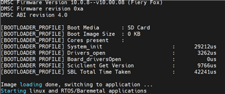

We are trying to adapt to the Nanya 2G DDR(NT6AN512T32AC-J1H) on our own TDA4VEN board, but it is not starting properly and only SBL has partial printing.
 I also uploade the syscfg and DDR data manuals.Please help me confirm if the DDR parameter configuration is correct?
