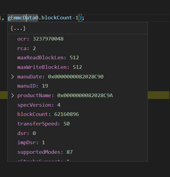

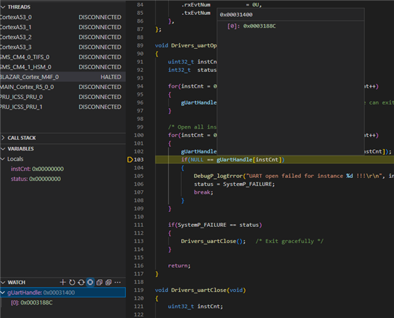

As the picture shown below, when hover onto an array, it shows address, not the actual value. Would like to have a feature similar to eclipse based CCS, that when hover on to it, it will show the actual value

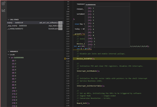

    I tested CCS with an int array, and it seems like the hover shows the correct value. See the screenshot below.
    Looking at the screenshot which you posted, according to watch view, gUartHandle[0] is a Hex type value. So the hover value seems to be correct.
    Could you try this feature again with a different array and see if you get output you expect?

    I updated the CCS, and seem with a not too large struct/array things are working fine
    But with a larger array like 4KB, the loading time seems take extreme long (minutes), could you please try a 4KB array on your side?

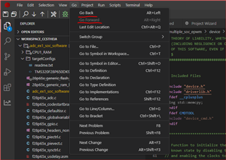

    2. Is there a similar functionality where we can go back to the file before CTRL+LEFT to dig into the function which is in another file.
    In Eclipse we were able to do it by clicking these two buttons

    Would you be able to attach a CCS project where I can reproduce the issue with large arrays?

    2) This functionality is available under the Go menu or through hotkeys.
    You can also add it to the toolbar by right-clicking on the toolbar, selecting "Add Command to Toolbar" and then searching for "Go Back"/"Go Forward".
    Another useful method of quickly navigating between recent files is pressing Ctrl+P which brings up the quick navigate menu.

    Regarding the large array. I won't be able to share the whole project, but here is what could be.
    #define MMC_BUF_SIZE (4*1024)
    uint8_t g_mmc_tx_buf[MMC_BUF_SIZE] __attribute__((aligned(128U)));
    uint8_t g_mmc_rx_buf[MMC_BUF_SIZE] __attribute__((aligned(128U)));
    int func()
        memset(g_mmc_tx_buf, 0, sizeof(g_mmc_tx_buf));
        memset(g_mmc_rx_buf, 0, sizeof(g_mmc_rx_buf));
       while(1)
    I hover on to the g_mmc_tx_buf, it will take pretty long to show the value on my side

  • Hi Dazong,
    This issue was being caused by a bug in the IDE that was causing performance issues with large arrays.
    This will be fixed as part of our next update in May.
