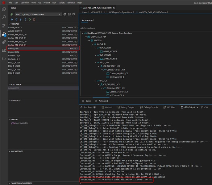

    CortexA15_0: GEL Output: --->>> AM572x Cortex A15 Startup Sequence In Progress... <<<---
    CortexA15_0: GEL Output: --->>> AM572x Cortex A15 Startup Sequence DONE! <<<---
    C66xx_DSP2: Error connecting to the target: (Error -1180 @ 0x0) Device is held in reset. Take the device out of reset, and retry the operation. (Emulation package 9.4.0.00129)

    Then find the menu above that has Scripts-->AM57x_MULTICORE Initialization-->DSPSSClkEnable_API
    Should look like this:
     GEL Output: --->>> DSP1SS Initialization is in progress ... <<<---
    CortexA15_0: GEL Output: DEBUG: Clock is active ...
    CortexA15_0: GEL Output: DEBUG: Checking for data integrity in DSPSS L2RAM ...
    CortexA15_0: GEL Output: DEBUG: Data integrity check in GEM L2RAM is sucessful!
    CortexA15_0: GEL Output: --->>> DSP1SS Initialization is DONE! <<<---

    My question is, why now? This was working last week...perhaps some GEL files (whatever they are and do) got deleted during clean up and migration? I
    Something in your setup was releasing the core from reset, this doesn't just happen. Please take note of the exact procedure being followed in the working scenario.

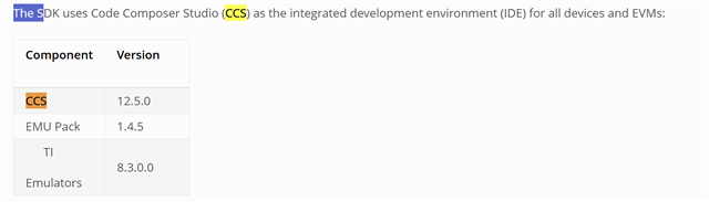

    On another note, is this migration to CCS 20 needed? Support for TI-RTOS has been deprecated in these releases.
    Are you using another OS?
    -Josue
  • Please note this issue exists in CCS Version 10.x also. Yes, we use TI RTOS. I believe this is a glitch/ vulnerability in TI tool chain that is causing us a lot of harm and loss of productivity. We now have 3 boards, and all have the same issues, in 2 different physical locations. They all function but we just can't debug. Please talk to the experts and get back to me with a phone call at 248-797-9758.

  • Chandran,
    Based on our meeting online meeting, I observed that the issue was that the cores were not initialized.
    After helping you set up the target configuration, we validated that you were able to connect core.
    I consider this thread as resolved. Keep in mind that CCS20 is not supported by AM57x at this time.
    For the supported CCS versions plese see the SDK release notes
    https://software-dl.ti.com/processor-sdk-rtos/esd/AM57X/09_03_00_00/exports/docs/devices/AM57X/rtos/Release_Specific_Release_Notes.html
    -Josue
  • Keep in mind that CCS20 is not supported by AM57x at this time.
    Just to clarify, CCS 20 does technically have debug support for AM57x. I was able to create a configuration and launch a debug session for an AM572x EVM configuration, connect to the A15, then use the GEL hotmenu to pull the DSP out of reset and then connect to the DSP.
    So while debug is possible with CCS 20, whether it is recommended (supported) by the device team is another story.
