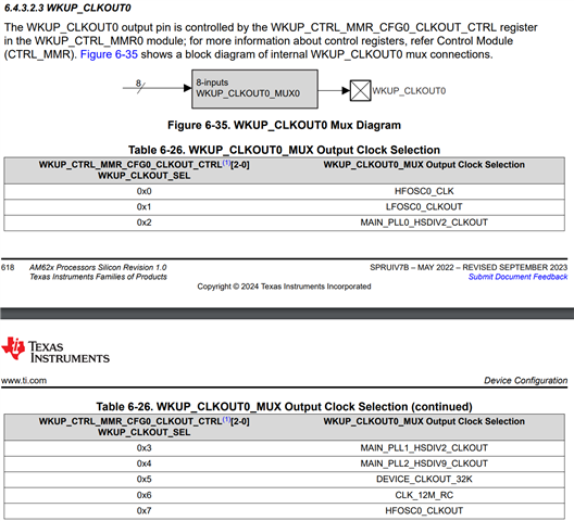

I'm trying to configure the WKUP_CLKOUT0 pin to output 32KHz instead of 25MHz. This is for an external WiFi module connected via an M.2 interface. The processor on our board is an AM6232A.
I have the following device tree section...

...but can't work out what I need to add for 'assigned-clocks'.
I've found this in the TRM...
and this from software-dl.ti.com/.../clocks.html
We have a 32.768KHz crystal connected externally across the WKUP_LFOSC0_X... pins.
How do I configure my DTS file to route the LFOSC0 clock to the WKUP_CLKOUT0 pin?
