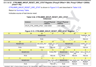

Could you let me know how to check reset reason ?
When I check CTRLMMR_WKUP_RST_STAT Register, it is 0x00010001 even after power on reset
root@j7200-evm:~# devmem2 0x43018178
/dev/mem opened.
Memory mapped at address 0xffffb348f000.
Read at address 0x43018178 (0xffffb348f178): 0x00010001
Is there any register which I can distinguish below reset reason ?
- warm reset
- power on reset
- watchdog reset

  • Hi Jace,
    In the TRM CTRLMMR_WKUP_RESET_SRC_STAT gives the reasons for reset.

  • Hi Jace,
    You could monitor bit19 of the same register for cold_out_rst this is set for watchdog reset as suggested by our hardware experts.
    - Keerthy
  • Hi Keerthy.
    I tested watchdog with TDA4VM board.
    I triggered watchdog by wdctl and the board reboot after 60 seconds
    But when I check 0x43000050, all bits were '0'.

    => md.l 0x43000050 1
    43000050: 00000000                             ....
    => md.l 0x43002050 1
    43002050: 00000000                             ....
    43000050: 00000000
    Could you double check watchdog function with EVM.

  • Okay. I will let the hardware experts know about this behaviour. Other than this bit we do not have any other way.
    Keerthy
    If you have access to JTAG or a debugger can you read the same via M3 register & double confirm that bit19 reads 0?
    - Keerthy
