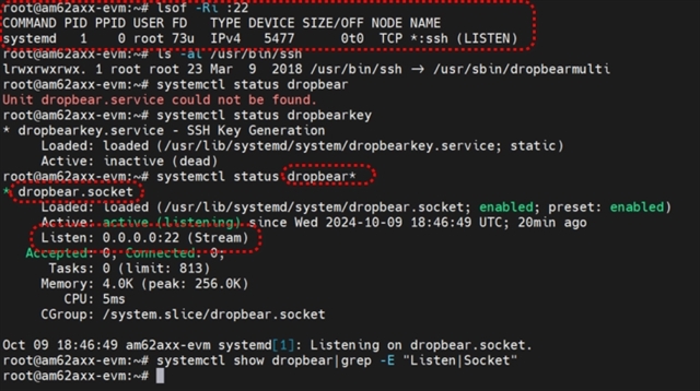

AM62A7-Q1: cybersecurity risk
Part Number: AM62A7-Q1

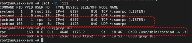

There are some process lisense 0.0.0.0 address,  they are not security.
Why these process need to lisence 0.0.0.0. could you remove the function?
  • I'm not fully clear on what is it that you are asking? Dropbear is a lightweight optimized ssh server, it listens to TCP port 22 as any ssh server.
    By default TI SDKs include dropbear as the ssh implementation, but you are free to not include it.
