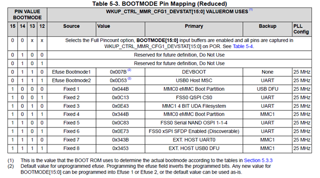

is there a guide on how to program the new bootmodes configurable by Efuses on the AM62L SoC?

    You'll find reduced boot mode info in "5.3.2 BOOTMODE Pin Mapping (Reduced Pincount)" in AM62L TRM

    Here is one of options we're currently exploring internally on the reduced boot mode efuse writer.
    1/. The core efuse programming service is provided by TIFS/SYSFW via the new TISCI boot mode efuse programming API.
    2/. The new TISCI boot mode efuse programming API is called by u-boot with
    - VPP “ON/OFF” control/configuration
    - serial terminal configuration etc...
    The example flow on running u-boot based boot mode efuse writer on customer board
    a/. configure backup boot mode with the reduced bootstrap pin (4), for example,
    - select USB-DFU as backup boot mode with BOOTMODE[15:12]=1000 (Fixed 1 mode)
    - select SD as backup boot mode with BOOTMODE[15:12]=1011 (Fixed 4 mode)
    b/. boot the u-boot based boot mode efuse writer from the selected backup boot mode
    c/. program the boot mode efuse (either Efuse Bootmode1 or Efuse Bootmode2) with the new value for the new intended primary/backup boot modes
    Once the new reduced boot mode efuse is programmed successfully
    d/. reconfigure the reduced bootstrap pin (4) to select either Efuse Bootmode1 or Efuse Bootmode2
    - BOOTMODE[15:12]=0110 to select Efuse Bootmode1
    - BOOTMODE[15:12]=0111 to select Efuse Bootmode2
    e/. boot SW...
