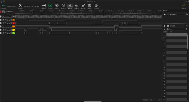

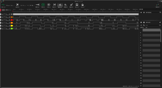

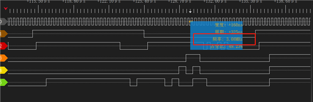

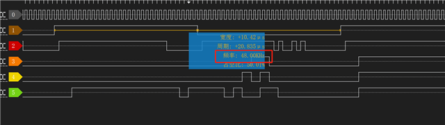

  • Hi Suren,
    When I use the device tree, the card cannot be registered, log:
    [ 9.268032] davinci-mcasp 2b00000.audio-controller: ASoC: error at snd_soc_dai_set_fmt on 2b00000.audio-controller: -
    22
    [ 9.284788] asoc-simple-card: probe of sound failed with error -22
    I add "format = "i2s" "  in dailink:
    sound_master: pdm-to-i2s {
    #sound-dai-cells = <0>;
    compatible = "adi,adau7002";
    codec_audio: sound {
    compatible = "simple-audio-card";
    simple-audio-card,name = "AM62x-SKEVM25";
    simple-audio-card,format = "dsp_b";
    simple-audio-card,bitclock-master = <&sound_master>;
    simple-audio-card,frame-master = <&sound_master>;
    simple-audio-card,dai-link@0 {
    format = "i2s"
    cpu {
    sound-dai = <&mcasp0>;
    codec {
    sound-dai = <&sound_master>;

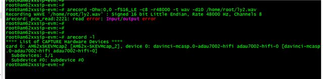

    The sound card can be registered, but when I use:
    root@am62xx-evm:/proc/asound/AM62xSKEVM25/pcm0c# arecord -fS32_LE  -c 8 -D hw:0,0 /tmp/test.wav
    the log:
    [ 310.624612] davinci-mcasp 2b00000.audio-controller: Too fast reference clock (96000000)
    [ 310.632672] davinci-mcasp 2b00000.audio-controller: Sample-rate is off by 400 PPM
    Recording WAVE '/tmp/test.wav' : Signed 32 bit Little Endian, Rate 48000 Hz
    arecord: pcm_read:2272: read error: Input/output error
    mcasp0:

  • Hi Roy,
    you have configured as I2S and tdm-slots=2 can you please run the arecord command with -c 2 option and see if it works
    Suren

    but I used the commend:
    arecord -Dhw:0,0 -fS32_LE -c 8 -r 48000 -t wav /tmp/test.wav, the log show:
    arecord:pcm_read:2221  read:error:Input/output error
    -c 2 is the same error.
    The use 4 adc, each adc provide 2ch data, total provide 8ch data, the bck is 3.07Mhz, the fclk is 48000, provide by external clk_gen.

    The dai_fmt is 0x4301 is correct? The log seems normally.
  • By the way, do we support 4ADC/2CH merget to 8ch tmd format?

  • Hi Suren,
    When customer uses the command shown in the figure, the waveform displayed on the logic analyzer  is shown in the first 4 figures.
    The waveform from top to bottom are BCLK, FSYNC and data 1-4.
    If there is a problem with the mic, the arecord command should not fail, it would just record distorted or poor-quality wav file.
