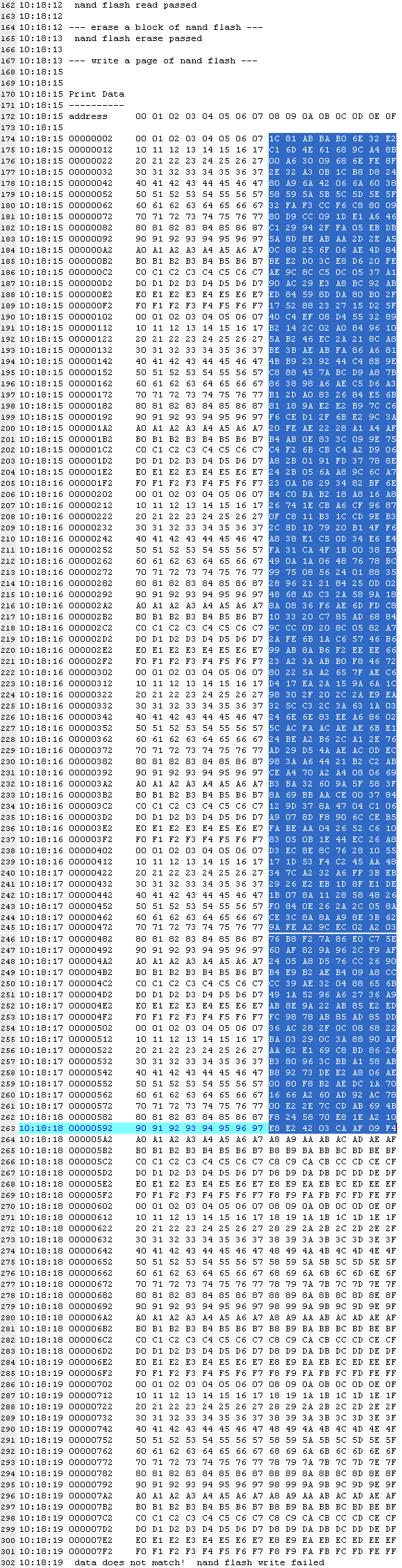

  • What types of errors are you seeing? Are they single bit errors or completely corrupted data? Are you sure you are not placing the data in memory regions that might be getting overwritten?
    Jeff

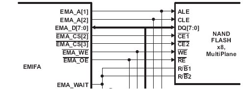

  • hi jc-ti:
            Below is the error;    The blue sector is the error filed.  The DDR2 connected as fingure1.Nandflash conneted as fingure2.
    Please help me analysize it ,thanks!
    In addtion, I test DDR2 via the interal RAM of DSP ,the test is ok.
    I test Nandflash via the interal RAM of DSP,the test is ok. the test program is same.
    I use the DDR2 RAM to test nand flash ,The error occured as discribed. the DDR2 memory is  256MBytes, 16bits width, two 128MB 8bits DDR2 chips
    CPU top view: OMAPL138AZWT $7-0BACV5W FR G1
                                                                                               figure1

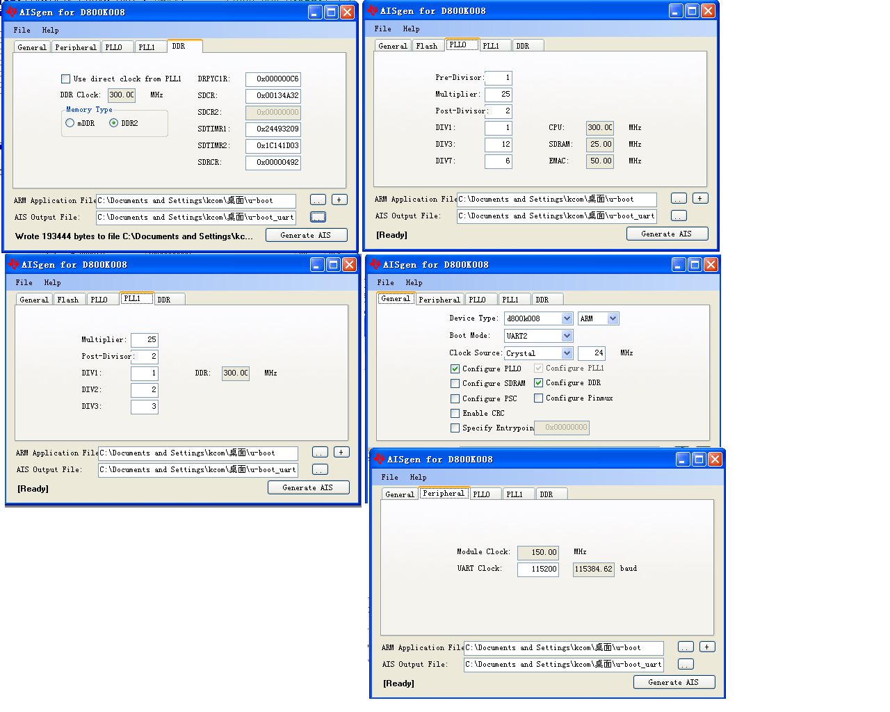

  • hi Jeff,
         1) I Try running the attached DDR test to see if it reports any failures,there is no failures,,
        2) I change my for loop code as you said, the test  passed.
       3) I tried to boot from uart2,but boot failed. I applied with steps under below:
    first, I rebuilid my uboot, got uboot elf file.
    second, I imported the uboot elf to AISgen tool for D800K008, got  a u_boot_uart.bin.
    Third,open the OMAPL138 Host tool V1.3 ,import the u_boot_uart.bin file ,start,reset and power on my board, some informations displayed,but boot failed :

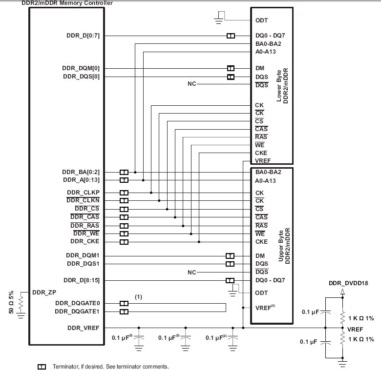

  • Based on this post, it appears there is an addressing issue.  That pattern is pointing at an addressing issue.  Things to check:
    1) Make sure the DDR EMIF settings are correct and match the DDR devices used.  DDR EMIF settings are the number one cause of DDR EMIF issues.  Make sure to check things like bus turn around time.  Errors in this setting may not show with a memory test but will cause havoc when trying to do real stuff.
    2) Make sure the DDR device is connected properly.  Check the schematic and check the netlist as well as the PCB layout.
    3) Make sure you memory test tests addressability.  Simple memory tests generally don't look for this and what could be happening is a write much later in time is corrupting the data in byte 08.  It may be worth seeing if you can just do byte 0-F properly, then try the next 16 bytes.
    4) It is possible there is some manufacturing problem causing a connection issue with the DDR.
    5) The error pattern is very distinctive and is your smoking gun.  Its very distinctive and odd and points away from a timing problem.  A timing problem would affect all addresses.
    6) It may be worth trying a constant pattern of zeros or F's to see if that works.  If it does, then that is also an indication of an addressing problem.
    7) Make sure ODT is actually grounded on the memory device.
    -Mike
  • hi Jeff,
           I configure the ddr2 freq. at 132MHz, the boot information seems the booting ok, but I connect serial terminal at COM4, but can't not see anything, the uboot CMD line can't display.Is there any other problem.thanks!

    (AIS Parse): Processing command 21: 0x5853590D.
    (AIS Parse): Performing Opcode Sync...
    (AIS Parse): Executing function...
    (AIS Parse): Processing command 22: 0x58535901.
    (AIS Parse): Loading section...
    (AIS Parse): Loaded 152056-Byte section to address 0xC1080000.
    (AIS Parse): Processing command 23: 0x58535901.
    (AIS Parse): Loaded 31664-Byte section to address 0xC10A51F8.
    (AIS Parse): Processing command 24: 0x58535901.
    (AIS Parse): Loaded 8008-Byte section to address 0xC10ACDA8.
    (AIS Parse): Processing command 25: 0x58535901.
    (AIS Parse): Loaded 1596-Byte section to address 0xC10AECF0.
    (AIS Parse): Processing command 26: 0x58535906.
    (AIS Parse): Performing jump and close...
    (AIS Parse): AIS complete. Jump to address 0xC1080000.
    (AIS Parse): Waiting for DONE...
    (AIS Parse): Boot completed successfully.
    (Serial Port): Closing COM4.
