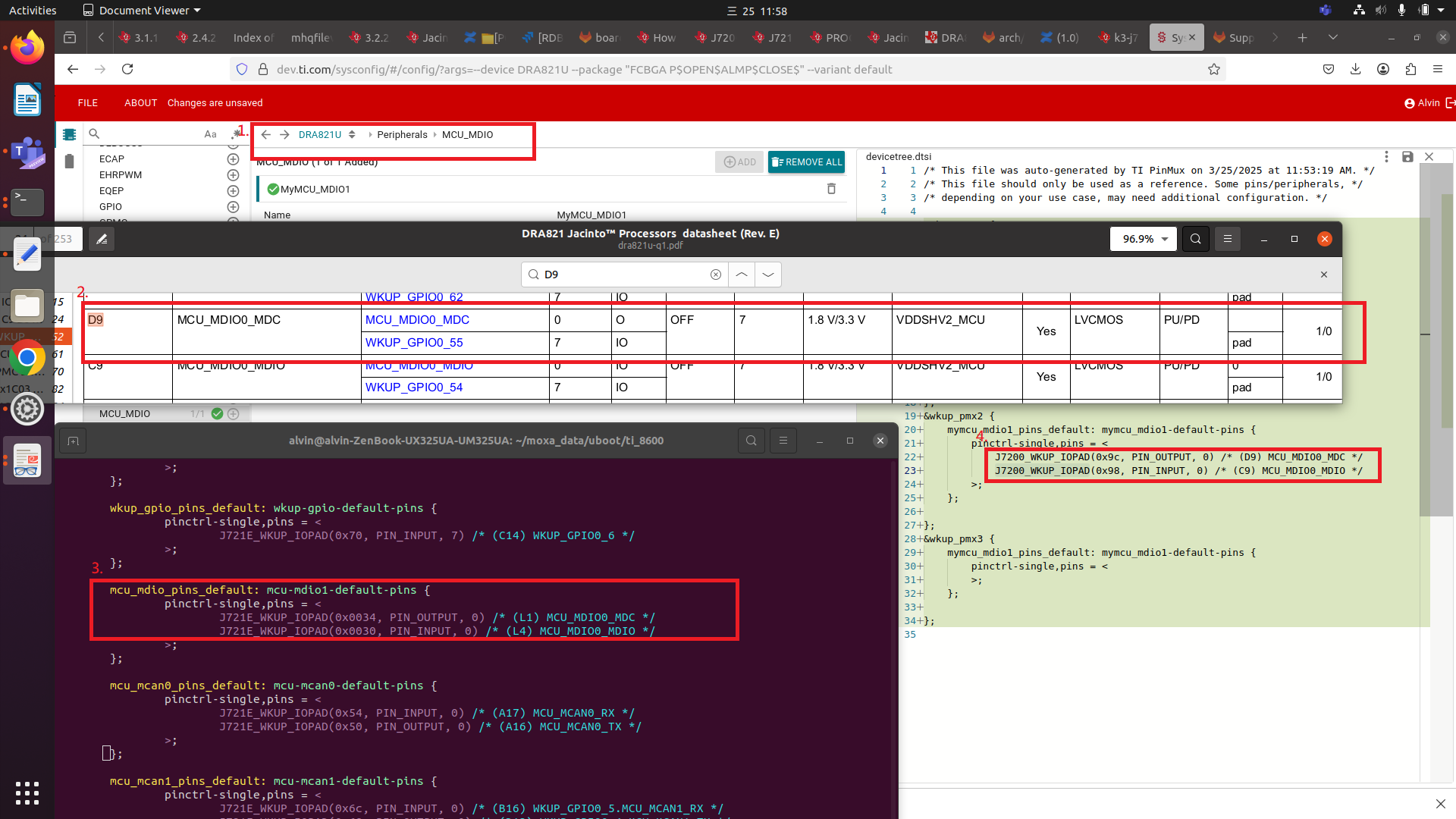

In SDK,  j7200 arch/arm/dts/k3-j7200-common-proc-board.dts will use "J721E_WKUP_IOPAD" define and MCU_MDIO0_MDC and MCU_MDIO0_MDIO are using offset 0x34 and 0x30 and the comment show pin L1 and L4 respectively.
However, DRA821U MCU_MDIO0 are pin D9 and C9 on datasheet.
By using SYSCONFIG to generate DTS, it will create all pin define in "J7200_WKUP_IOPAD" and offset for these two pins are 0x9C and 0x98. ( I cannot map the register offset address and pin for PADCONFx from TRM which it doesn't specify which pin(ball) is mapping to PADCONFx.)
We can only choice to believe SYSCONF, but now customer is confusing on how to use the DTS back to work with SDK original Device tree.
Secondary, customer tried to modify mcu_mdio_pins_default-pins to the correct pins but found MDIO will not work after change to correct pins.
It seems current setting is correct but we cannot tell which pins are used right now.
The EVM hardware use pin D9 and C9 as SYSCONF tool show.
Customer wonder how to set these two pins on their own board once their board is ready.

    I'm not entirely sure why MCU_MDIO0_MDC and MCU_MDIO0_MDIO have comments which state they are L1 and L4 in the SDK; they may be reused comments from another device. The correct pins are D9 and C9 as the datasheet specifies. That being said, the offsets specified are correct— I will explain below.
    In the datasheet, Table 6-106. Pin Multiplexing shows the 0x98 and 0x9C offset as you specify in your post. From the SoC design perspective, this is the correct offset from the base address of 0x4301C000.
    The reason why the offsets '0x34' and '0x30' are correct is because the Linux SDK splits the configuration registers into different regions, resulting in various base addresses. MCU_MDIO0_MDC and MCU_MDIO0_MDIO fall under the third region (wkup_pmx2) which has a base address of 0x4301C068. This requires the datasheet offset to be adjusted by 0x68 to have the proper offset from the region's base address.
    In other words, SDK Offset = Datasheet Offset - SDK Region Base Address. Examples:
    • MCU_MDIO0_MDC: 0x9C - 0x68 = 0x34
    • MCU_MDIO0_MDIO: 0x98 - 0x68 = 0x30

    Thanks for bringing to my attention that the online SysConfig Pinmux Tool is populating the wrong offset despite being in the correct region. I will file a ticket internally and get this fixed for the next release.
