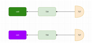

Hi TI,
SDK8.6
Single camera demo
Same camera/serializer/deserializer:
CSI0:  capture work ok
linkA->MAX96717->MAX96724->CSI0
 local_capture_config.chInstMap[0] = 0;
 local_capture_config.chVcNum[0] = 1;
CSI1:
linkA->MAX96717->MAX96724->CSI1
 local_capture_config.chInstMap[0] = 1;
No data captured, Single camera demo block at vxGraphParameterDequeueDoneRef.
What else needs to be modified when switching from CSI0 to CSI1? Very urgent question, looking forward to your reply.
  • chInstMap[0] = 0; chVcNum[0] = receive VC1; OK.
    chInstMap[0] = 1; chVcNum[0] = receive VC1; Why not?
    When connected to CSI1, we can't use chVcNum[0]? What are we missing?
  • Can experts update this?
    After switching to CSI1: The deserializer has received the data, but TDA4 has not actually received it.

    CSI1:     no

    Looking forward to your reply.
  • hi Barry,
    There is no other change required, you would just need to change instance id and channel to instance mapping.. and as long as deserializer and camera are connected in the same manner as CSI0, it should work. Have you made sure that they are being configured?
    Brijesh
  • Hi Brijesh
    Same camera.
    Two identical deserializers corresponding to CSI0 and CSI1 respectively.
    Same serdes configuration.
    just like the log above, CSI0 works but CSI1 does not work.
    What could be the reason? Looking forward to your help.
  • Please close, Hardware Issues.
  • Thanks Barry, closing this thread.
