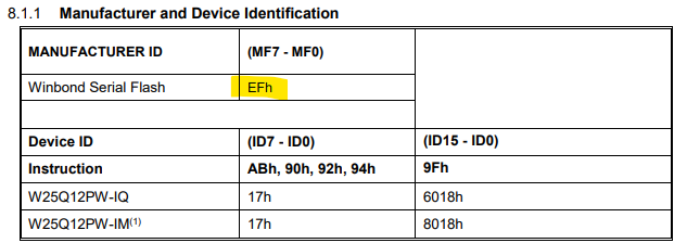

  • As said, we bought a 128 Mb flash (W25Q12PWSFIM) and are trying to boot from this. If we trying to probe the flash without adding the specific drivers we get the following issue:
    sf probe
    jedec_spi_nor flash@0: unrecognized JEDEC id bytes: df, 00, 30
    Failed to initialize SPI flash at 0:0 (error 0)
    After including the JEDEC id and adding the following line in drivers/mtd/spi/spi-nor-ids.c:
    { INFO("w25q12pwsfim", 0xdf0030, 0, 64 * 1024, 256, SECT_4K | SPI_NOR_DUAL_READ | SPI_NOR_QUAD_READ ) }

  • So this thread now discusses 3 (!)  different Flash parts; I'm a bit confused what is going on here actually.
    1. W25Q01JVSFIQ
    2. MX25U51245GMI00
    3. W25Q12PWSFIM
    Assuming what you want now is #3, something very basic is off.
    When I search for the datasheet for this W25Q12PW part I find this here: https://www.winbond.com/hq/support/documentation/downloadV2022.jsp?__locale=en&xmlPath=/support/resources/.content/item/DA00-W25Q12PW.html&level=1
    Is this the correct datasheet?
    It is a Winbond part, and it has a manufacturer ID of EFh. However what you are reading is DFh? If that's the case there could be some basic electric/connectivity issue that you would want to analyze further. You may also want tom reduce the SPI clock speed to see if this helps in any way.
    Regards, Andreas

  • So we switched to W25Q12PWSFIM which is 128 Mb but are getting the issues mention in the last question.
    So the JTAG manufacturer ID you should be reading is 0xEF. But you are reading 0xDF, which is not correct. Looks like two bits in the sequence are flipped. I know you mentioned earlier you were able to successfully probe a different Flash chip which means the basic wiring should be ok but perhaps there's something about using that W25Q12 chip that makes it more sensitive to noise/signaling in your setup.
    Since you are using a socket (which should probably never be used for production), you should try to derate the transfer speed/parameters to see if you can get the chip ID to read correctly, even if it is just for testing purposes.
    Try changing these things here (example):
