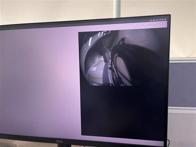

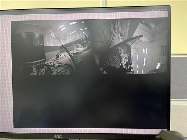

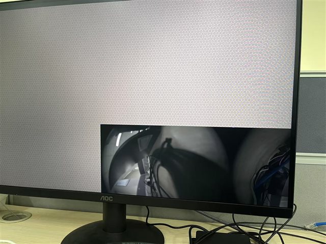

Hi expert,
My goal is to achieve the mosaic of the images from two X3C cameras on the TDA4 development board. Since I only have two cameras, I have temporarily enabled the display of the two channels. Each of the two channels can display the image separately, but they cannot be displayed simultaneously. Could you please tell me what's wrong with it?

GST_DEBUG=3 gst-launch-1.0 \
v4l2src device=/dev/video19 ! video/x-bayer, width=1920, height=1280, format=bggr12 ! queue leaky=2 ! tiovxisp sink_0::device=/dev/v4l-ox03c10-subdev0 sensor-name=SENSOR_SONY_OX03C10_UB953_D3 dcc-isp-file=/opt/imaging/ox03c10/wdr/dcc_viss_wdr.bin sink_0::dcc-2a-file=/opt/imaging/ox03c10/wdr/dcc_2a_wdr.bin format-msb=11 !  video/x-raw, format=NV12, width=1920, height=1280 ! queue ! mosaic.sink_0 \
v4l2src device=/dev/video20 ! video/x-bayer, width=1920, height=1280, format=bggr12 ! queue leaky=2 ! tiovxisp sink_0::device=/dev/v4l-ox03c10-subdev1 sensor-name=SENSOR_SONY_OX03C10_UB953_D3 dcc-isp-file=/opt/imaging/ox03c10/wdr/dcc_viss_wdr.bin sink_0::dcc-2a-file=/opt/imaging/ox03c10/wdr/dcc_2a_wdr.bin format-msb=11 !  video/x-raw, format=NV12, width=1920, height=1280 ! queue ! mosaic.sink_1 \
tiovxmosaic name=mosaic \
sink_0::startx="<0>" sink_0::starty="<0>" sink_0::widths="<960>" sink_0::heights="<640>" \
sink_1::startx="<0>" sink_1::starty="<640>" sink_1::widths="<960>" sink_1::heights="<640>" \
queue ! video/x-raw, width=1920, height=1280 ! queue ! kmssink driver-name=tidss sync=false force-modesetting=true

mosaic_pad->width[0]:960, GST_VIDEO_INFO_WIDTH(&video_info):1920, width:0
0:00:01.486513710  1988     0x24e98d20 FIXME             aggregator gstaggregator.c:1412:gst_aggregator_aggregate_func:<tiovxisp1> Subclass should call gst_aggregator_selected_samples() from its aggregate implementation.
mosaic_pad->width[1]:-1, GST_VIDEO_INFO_WIDTH(&video_info):1920, width:960

  • In addition, I can see that the AE (Auto Exposure) and Gain are constantly calculating data according to the current environment.
    When I use the command "kmssink driver-name=tidss sync=false force-modesetting=true", it always fails. However, when I use the command "queue ! video/x-raw, width=1920, height=1280 ! queue ! glimagesink sync=false", I can display the stitched image. But it only works sometimes and fails at other times. When it fails, it seems to get stuck. When it succeeds, the position of the image is not fixed, as shown in the picture.
    May I ask if it is due to insufficient bandwidth? Or is there any other reason? Why does it succeed sometimes and fail at other times? Thank you very much for your help.
    What resolution is the display you have connected? Could you try running the following commands?
    media-ctl -V '"cdns_csi2rx.4504000.csi-bridge":0 [fmt:SBGGR12_1X12/1920x1280 field:none]'
    media-ctl -V '"4500000.ticsi2rx":0 [fmt:SBGGR12_1X12/1920x1280 field:none]'
    After doing so, try running:
    gst-launch-1.0 \
    v4l2src device=/dev/video19 ! video/x-bayer, width=1920, height=1280, framerate=30/1, format=bggr12 ! queue leaky=2 ! tiovxisp sink_0::device=/dev/v4l-ox03c10-subdev0 sensor-name=SENSOR_SONY_OX03C10_UB953_D3 dcc-isp-file=/opt/imaging/ox03c10/wdr/dcc_viss_wdr.bin sink_0::dcc-2a-file=/opt/imaging/ox03c10/wdr/dcc_2a_wdr.bin format-msb=11 !  video/x-raw, format=NV12, width=1920, height=1280 ! queue ! mosaic.sink_0 \
    v4l2src device=/dev/video20 ! video/x-bayer, width=1920, height=1280, framerate=30/1, format=bggr12 ! queue leaky=2 ! tiovxisp sink_0::device=/dev/v4l-ox03c10-subdev1 sensor-name=SENSOR_SONY_OX03C10_UB953_D3 dcc-isp-file=/opt/imaging/ox03c10/wdr/dcc_viss_wdr.bin sink_0::dcc-2a-file=/opt/imaging/ox03c10/wdr/dcc_2a_wdr.bin format-msb=11 !  video/x-raw, format=NV12, width=1920, height=1280 ! queue ! mosaic.sink_1 \
    sink_1::startx="<960>" sink_1::starty="<0>" sink_1::widths="<960>" sink_1::heights="<640>" ! \
    queue ! video/x-raw, width=1920, height=1080 ! queue ! kmssink driver-name=tidss sync=false force-modesetting=true
    Thank you,
    Fabiana

    If you modify the "height" in the last line to 1080, the following error will be reported:
    0:00:01.071945350  2277     0x1a1b5de0 WARN             tiovxmosaic gsttiovxmosaic.c:720:gst_tiovx_mosaic_check_dimension:<mosaic> Pad width: -1 is larger than input width: 1920, setting input width
    0:00:01.071961570  2277     0x1a1b5de0 WARN             tiovxmosaic gsttiovxmosaic.c:720:gst_tiovx_mosaic_check_dimension:<mosaic> Pad height: -1 is larger than input height: 1280, setting input height
    If you modify the "height" in the last line to 1280, the following error will be reported:
    root@j721e-evm:/opt/edgeai-gst-apps# GST_DEBUG=4 gst-launch-1.0 v4l2src device=/dev/video19 ! video/x-bayer, width=1920, height=1280, framerate=30/1, format=bggr12 ! queue leaky=2 ! tiovxisp sink_0::device=/dev/v4l-ox03c10-subdev0 sensor-name=SENSOR_SONY_OX03C10_UB953_D3 dcc-isp-file=/opt/imaging/ox03c10/wdr/dcc_viss_wdr.bin sink_0::dcc-2a-file=/opt/imaging/ox03c10/wdr/dcc_2a_wdr.bin format-msb=11 !  video/x-raw, format=NV12, width=1920, height=1280 ! queue ! mosaic.sink_0 v4l2src device=/dev/video20 ! video/x-bayer, width=1920, height=1280, framerate=30/1, format=bggr12 ! queue leaky=2 ! tiovxisp sink_0::device=/dev/v4l-ox03c10-subdev1 sensor-name=SENSOR_SONY_OX03C10_UB953_D3 dcc-isp-file=/opt/imaging/ox03c10/wdr/dcc_viss_wdr.bin sink_0::dcc-2a-file=/opt/imaging/ox03c10/wdr/dcc_2a_wdr.bin format-msb=11 !  video/x-raw, format=NV12, width=1920, height=1280 ! queue ! mosaic.sink_1 tiovxmosaic name=mosaic sink_0::startx="<0>" sink_0::starty="<0>" sink_0::widths="<960>" sink_0::heights="<640>" sink_1::startx="<960>" sink_1::starty="<0>" sink_1::widths="<960>" sink_1::heights="<640>" ! queue ! video/x-raw, width=1920, height=1280 ! queue ! kmssink driver-name=tidss sync=false force-modesetting=true

    The monitor is now displaying the images from the two cameras normally. I'm really grateful. Could you please tell me what problems I had before?
    I am happy to hear that it is working for you! I had assumed your display was 1920x1080, which is why I had previously changed the height in the last line to 1080. After you provided the monitor resolution, I then changed the width and height in line 7 to match it.
    Another thing I changed was the device subdev id name, which was obtained from your media-ctl -p output. This information is located in entities 44 & 48.
    Please mark my previous response as having resolved your question and if you have any further inquiries, I'll be glad to help.

    Sorry to bother you again. I've got four cameras now, but I've run into another problem.
    1. It fails to display the images of four cameras simultaneously.  The following error is displayed.
    [  921.676101] ds90ub960 5-003d: rx2 CSI error: 0xc
    [  921.680724] ds90ub960 5-003d: rx2 CSI checksum error
    [  921.685682] ds90ub960 5-003d: rx2 CSI length error
    [  922.221586] ds90ub960 5-003d: rx1 buffer error
    [  922.227764] ds90ub960 5-003d: rx3 buffer error
    [  922.232212] ds90ub960 5-003d: rx3 CSI error: 0xc
    [  922.236833] ds90ub960 5-003d: rx3 CSI checksum error
    [  922.241800] ds90ub960 5-003d: rx3 CSI length error
    [  922.764084] ds90ub960 5-003d: rx0 buffer error
    [  922.769119] ds90ub960 5-003d: rx1 buffer error
    [  922.774152] ds90ub960 5-003d: rx3 buffer error
    [  923.308087] ds90ub960 5-003d: rx0 buffer error
    [  923.313122] ds90ub960 5-003d: rx1 buffer error
    [  923.318153] ds90ub960 5-003d: rx2 buffer error
    [  923.323192] ds90ub960 5-003d: rx3 buffer error
    Here are my GStreamer commands. I modified them based on the commands for two cameras.
    gst-launch-1.0 -v \
    v4l2src device=/dev/video-ox03c10-cam0 io-mode=5 ! video/x-bayer, width=1920, height=1280, framerate=60/1, format=bggr12 ! queue leaky=2 ! tiovxisp sink_0::device=/dev/v4l-ox03c10-subdev0 sensor-name=SENSOR_SONY_OX03C10_UB953_D3 dcc-isp-file=/opt/imaging/ox03c10/wdr/dcc_viss_wdr.bin sink_0::dcc-2a-file=/opt/imaging/ox03c10/wdr/dcc_2a_wdr.bin format-msb=11 sink_0::pool-size=8 src::pool-size=8 ! video/x-raw, format=NV12, width=1920, height=1280 ! queue ! mosaic.sink_0 \
    v4l2src device=/dev/video-ox03c10-cam1 io-mode=5 ! video/x-bayer, width=1920, height=1280, framerate=60/1, format=bggr12 ! queue leaky=2 ! tiovxisp sink_0::device=/dev/v4l-ox03c10-subdev1 sensor-name=SENSOR_SONY_OX03C10_UB953_D3 dcc-isp-file=/opt/imaging/ox03c10/wdr/dcc_viss_wdr.bin sink_0::dcc-2a-file=/opt/imaging/ox03c10/wdr/dcc_2a_wdr.bin format-msb=11 sink_0::pool-size=8 src::pool-size=8 ! video/x-raw, format=NV12, width=1920, height=1280 ! queue ! mosaic.sink_1 \
    v4l2src device=/dev/video-ox03c10-cam2 io-mode=5 ! video/x-bayer, width=1920, height=1280, framerate=60/1, format=bggr12 ! queue leaky=2 ! tiovxisp sink_0::device=/dev/v4l-ox03c10-subdev2 sensor-name=SENSOR_SONY_OX03C10_UB953_D3 dcc-isp-file=/opt/imaging/ox03c10/wdr/dcc_viss_wdr.bin sink_0::dcc-2a-file=/opt/imaging/ox03c10/wdr/dcc_2a_wdr.bin format-msb=11 sink_0::pool-size=8 src::pool-size=8 ! video/x-raw, format=NV12, width=1920, height=1280 ! queue ! mosaic.sink_2 \
    v4l2src device=/dev/video-ox03c10-cam3 io-mode=5 ! video/x-bayer, width=1920, height=1280, framerate=60/1, format=bggr12 ! queue leaky=2 ! tiovxisp sink_0::device=/dev/v4l-ox03c10-subdev3 sensor-name=SENSOR_SONY_OX03C10_UB953_D3 dcc-isp-file=/opt/imaging/ox03c10/wdr/dcc_viss_wdr.bin sink_0::dcc-2a-file=/opt/imaging/ox03c10/wdr/dcc_2a_wdr.bin format-msb=11 sink_0::pool-size=8 src::pool-size=8 ! video/x-raw, format=NV12, width=1920, height=1280 ! queue ! mosaic.sink_3 \
    sink_0::startx="<0>" sink_0::starty="<0>" sink_0::widths="<640>" sink_0::heights="<360>" \
    sink_1::startx="<640>" sink_1::starty="<0>" sink_1::widths="<640>" sink_1::heights="<360>" \
    sink_2::startx="<0>" sink_2::starty="<360>" sink_2::widths="<640>" sink_2::heights="<360>"  \
    sink_2::startx="<640>" sink_2::starty="<360>" sink_2::widths="<640>" sink_2::heights="<360>" ! \
    video/x-raw, width=2560, height=1440 ! kmssink driver-name=tidss sync=false
    In addition, sometimes when switching between the images of a single camera, the video stream may also fail to be output.  It needs to be restarted to be achieved. Could you give me some suggestions? Do I need to upgrade to the latest SDK version? Thanks!
