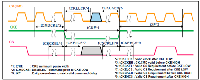

We sent a Toyota PWB populated with MT53E256M32D1KS-046 AAT:L to Micron for LPDDR4 testing and provided the SW image with the attached DDR configuration, below is their findings:
1. Training Summary:
1a. Write Leveling: MR2 bit 7 is NOT set-> unanswered. Pls clarify what needs to be done.
 1b. NO MR4 read command observed during initialization and normal operation->As per TI's response we got to know that it will be planned in future SDK release. In which SDK release this feature will be handled?
2.They couldn’t perform measurements on tCKCKEH, tCKELCK, tCMDCKE and tXP since CKE was always high
3. Self refresh:
tREFIpb and tPBR2PBR: Refresh PB command was not observed
tSR, tXSR and tESCKE: self-refresh command was not observed

    2.  You need to put the device in a low power mode to initiate self refresh.  Instructions were sent to Susan by Suren via email
    3. Per Bank refreshes are not enabled and not supported, only all bank refreshes are performed.  For self-refresh command to be observed, you need to put the device in a low power mode as stated earlier.

    2. we are not sure what you mean by “put the device in low power mode”. Can you please elaborate? & why it required what its purpose etc.

    2. Please refer to the email sent to Susan by Suren.  The processor needs to be in a low power mode to initiate a self-refresh command

    2. Putting LP4 in low power mode is NOT a common implementation in Automotive where aggressive power savings are not always needed.  Mobile uses every power savings feature possible for obvious reasons.
    CKE won't go low if we don't enter low power mode which is NOT required, same applies to self refresh.

    2. So then i don't think you would need to check any self-refresh related timing parameters
