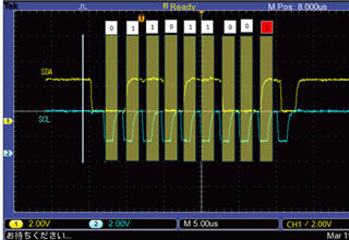

When I call I2C_probe() while supplying 3.3V power through the user expansion connector,
an error occurs, and when I check the waveform with an oscilloscope, it seems to be a NACK.
Also, the voltage has already risen from 0V to 0.7V before 3.3V is supplied from the user expansion connector.
Q1 Is it normal for the voltage to already rise to 0.7V before supplying 3.3V through the user expansion connector?
Q2 Is the error (NAK) in I2C_probe() due to the fact that it is 0.7V before rising to 3.3V?

    Can you please tell the waveform you shared above is captured for which I2C device?
    This waveform was taken when connecting the SK-AM64B to the MICROCHIP I2C device DT100104.
    Unfortunately, I have never been successful in probing this I2C device.

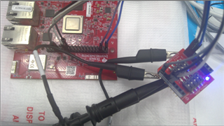

    A MICROCHIP I2C device (DT100104) is connected to the SK-AM64B user expansion connector with a jumper wire.
    When the SK-AM64B is powered on in this state, the voltage rises from 0V to 0.7V.
    If the MICROCHIP I2C device (DT100104) is not connected
    when the power is turned off and then on, the voltage rises from 0V to 3.3V.
    Why does the voltage rise from 0V to 0.7V only when the MICROCHIP I2C device (DT100104) is connected?
    SBL NULL has been flashed to the OSPI, so I don't think there are any signals.

  • Hi Sreenivasa,
    The MICROCHIP device is connected to PIN1 (3V3) of the user expansion connector using a jumper wire.
    Power is supplied through the following procedure.

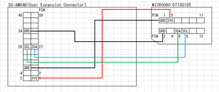

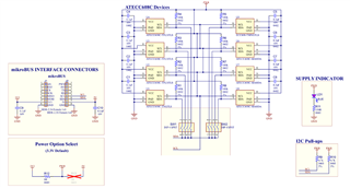

    Can you please make a hand diagram on the connections and share.
    the MCU_I2C0 interface has a pullup on the SK board. And the connection is similar to I2C0.
    Is there a pull on the add-on board?
    Have you checked the software configuration and the connection polarity.
    Sreenivasa
  • Hi Sreenivasa,
    We are using the I2C0 interface, not the MCU_I2C0 interface, and pull-up resistors are present on the onboard circuit.
    I have confirmed that the SDA and SCL lines are correctly connected between the SK board and the add-on board.
    The I2C pull-up resistors are present on the add-on board, and the voltage level is 3.3V, which matches the SK board.
    Regarding the software configuration, I have verified that the I2C instance and pinmux settings are correctly set for MCU_I2C0.
    The connection polarity is also correct, with SDA and SCL aligned as expected.
