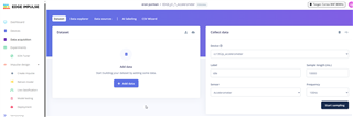

Next step, on Edge Impulse web interface, I have opened a new Accelerometer project to gather the data.

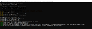

On PC command dialog, I ran the following: edge-impulse-daemon
I filled the login credentials for my Edge account, selected the correct XDS110 port and Baudrate and confirmed connection, as seen below:
On Edge Impulse, device could be seen as being connected:
On “Data Acquisition” the device was recognized as well and was set as seen below:
Now, I have pressed "Start Sampling" and that brought the issue seen below that suggests the Accelerometer is not communicating with the LaunchPad:
