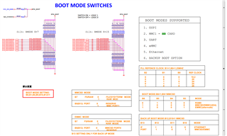

    The Boot mode is SD card priority mode, and the system cannot boot from SD card.

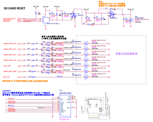

    After the SDCD signal is inserted into the SD card, the level of CLK will become low, and the CLK level will not change.

  • If you don't see MMC1_CLK toggle, then most likely the boot signals are not getting latched correctly.
    -First, ensure that you don't see any MMC1_CLK.  Probe the MMC1_CLK as you power up the board.  Do you see any clock toggle after power up?
    -Next, ensure the boot signal pull resistors are installed correctly.  From the schematic, i can't tell which resistors are populated and which aren't.
    -Are your SYS_BOOTMODEx signals connected to other peripherals?  Need to ensure there is no contention around the time reset is released.

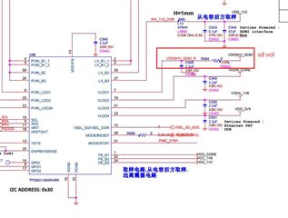

    -Check the power to the card.  I see two voltage rails VDDSHV_SDIO and VCCIO_SD, are these both at 3.3v initially when booting and are the supplies stable?
    -You may need to remove the capacitors and series resistors on the data and control signals.  Those should not be necessary.

  • I measured the boot signal and it looks like the level is up to standard and the comparison timing looks up to standard

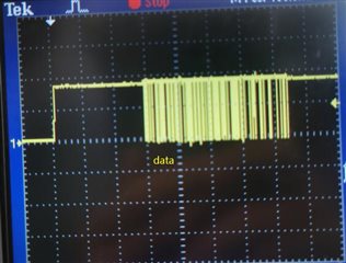

  • Now the SD clock has always been there, the data signal is only 200ms signal, and the debug port is still not output
  • Ok, so it appears that the processor is attempting to boot from the card, but is failing.  What is the voltage level of the data signal?  It should be 3.3V

  • What's the frequency of the clock?  Initially it should be 400KHz, then switch to 25MHz, then go higher if SBL is executing.
    Do you see the frequency change from 400KHz to 25MHz?  If you don't see it switch to 25MHz, try a different SD card (ideally from a different manufacturer).  If you see it go to 25MHz, the card voltage should switch to 1.8V before the change to higher frequency.  Can you check to see if this is happening?

  • the frequency of the clock is 25Mhz , this 1.8V voltage refers to which part of the SD card voltage?
  • SD card IO voltage needs to change from 3.3v to 1.8v.  I looks like the 25MHz clock is showing 3.3v.  But this would need to change to 1.8v to operate at HD200.   This voltage needs to be connected to a selectable LDO to control the voltage during different operating mode of the SD card (see EVM for an example)
    Has this been setup properly on your board?
    Also, the dts in uboot needs to specify what controls this LDO.  Here's an example from k3-am625-lp-sk.dts showing control using GPIO0_31 pin:
    vddshv_sdio: regulator-4 {

    If you don't have provisions to change this voltage, you would need to ensure the dts doesn't allow the switch to 1.8v, like this in k3-am625-lp-sk.dts:

  •  The PMIC I am using now is TPS6521904RHBR, and the SD card control power supply is VLDO1, which has been measured at 3.3V. What might be the cause? We use the same design as the EVM, which will change to 1.8V in the EVM. I am a little confused. The dts modification you mentioned should be controlled only after uboot is run, but I don't see any output from the debug interface now.
  • Correct, the voltage switch will occur later.

    -Have you removed the caps from the MMC signals?  These are not on the EVM.  Also, change the 33ohm series resistors to 0ohm.  The series resistance should not be needed

    - The capacitor on the MMC signal has been removed, and the change of 33Ω to 0Ω has been verified, but it still cannot be done.
