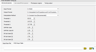

I am currently doing the tuning of AR0823 8MP RGBIR sensor (4*4) using DCC tool.
We are using TDA4VEN board and using Linux sdk version 10_00_00_05.
For the PCID tuning one input we need is "PCID Input Table” in DCC tool
Q) how to generate this input table? Is this table the output of other blocks tuning?
Ajay Jose
  • Hi Ajay,
    That is for mapping 16-bit PCID output IR image to 12-bit going to DDR.
    Please refer to the plugin guide for detail.
    What is the dynamic range of the pixel output?
    PCID has a limitation of 16-bit linear input.
    If you sensor output is too high in dynamic range, PCID cannot process it correctly for IR subtraction.
