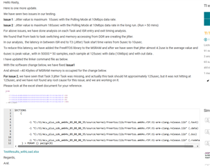

        Sorry for update.Following your suggestions for re-testing, the interrupt response latency has been significantly reduced when running only a single task. The root causes appear to be the two factors you mentioned: FreeRTOS' interrupt-disabling operations in critical sections and context switching overhead. How can these two factors be optimized to reduce the latency?
  • Hello ,
    I am not sure if the application runs on MSRAM or DDR.
    If the application runs on the DDR , keep it in the MSRAM.
    If the MSRAM is not sufficient to run an application, then at least keep the freertos library files in the MSRAM. This will reduce the jitter.
    Other than this method, there are no methods to reduce jitters.
    Anil.
    I need to use inter-core communication, so it must run on DDR. Are there any methods to reduce this latency response?
  • Hello ,
    To reduce the jitter, we need to keep the FreeRTOS library code in MSRAM memory and keep remain code in the DDR memory.
    The FreeRTOS library needs almost 40KB Memory. So, try this method and other than this we can't remove critical sections in the Application.
    The linker cmd patch details are available in the link below .
    https://e2e.ti.com/support/tools/code-composer-studio-group/ccs/f/code-composer-studio-forum/1326858/am243x-freertos-jitter?pifragment-323357=2#5433121
