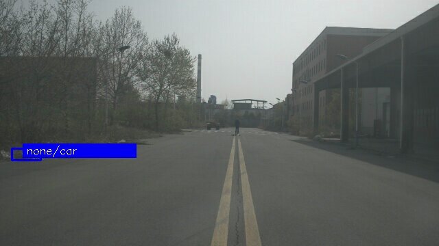

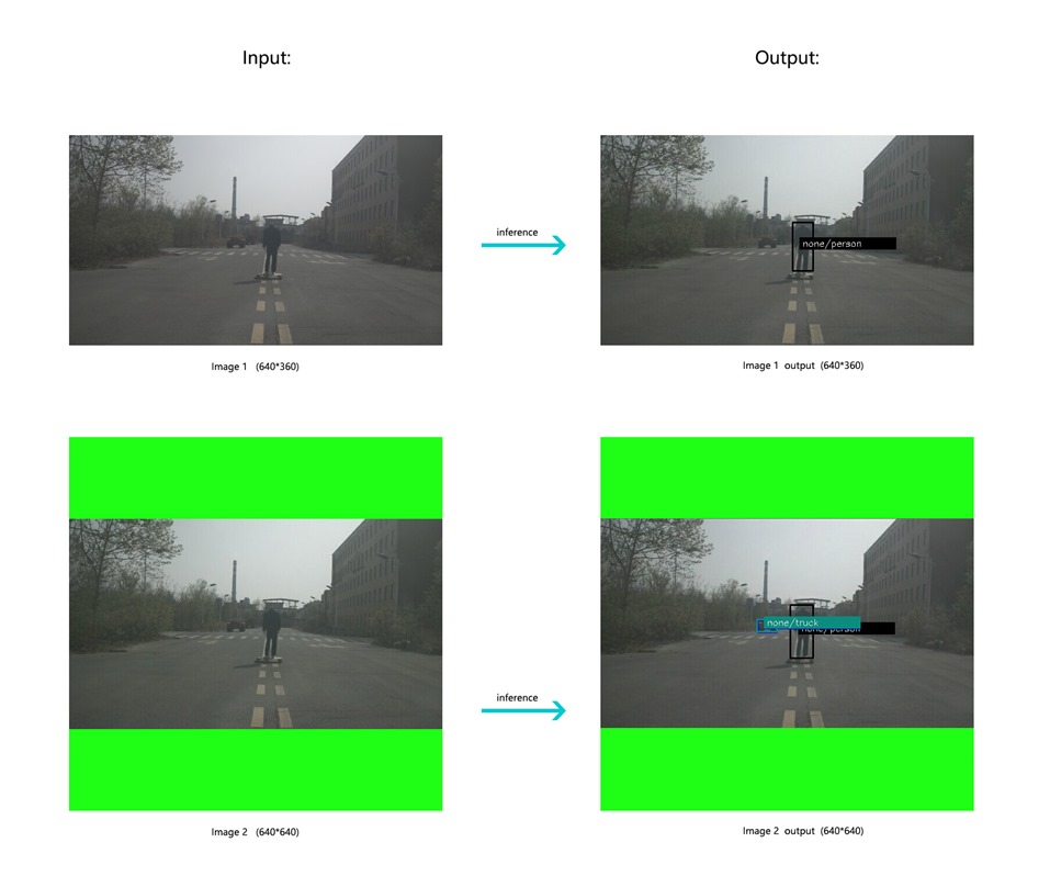

I'm working with the apps_python code under edgeai-gst-apps to process input images of size 640x360, padding them to 640x640 by adding borders to both top and bottom for neural network inference as belows:

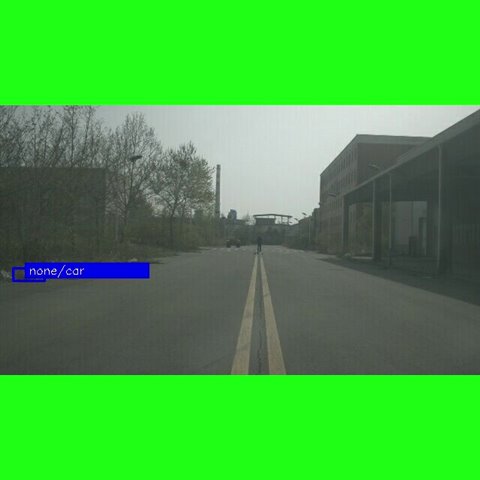

The modified code is as follows:
def get_dl_scaler_elements(flow, is_multi_src):
        dl_scaler_caps = "video/x-raw, width=%d, height=%d" % tuple(resize) #640*640
        elif flow.input.width / resize[0] < 1 or flow.input.height / resize[1] < 1:
            caps = "video/x-raw, width=%d, height=%d" % (
                flow.input.width,
                flow.input.height,
            queue_element = make_element("queue", caps=caps)
            scale_element = make_element("videobox", property = {"top":-140,"bottom":-140,"fill":1})
            scale_element += make_element("capsfilter", caps=dl_scaler_caps)
        else:
            queue_element = make_element("queue", caps=dl_scaler_caps)
        elem_list = queue_element
        if scale_element != None:
            elem_list += scale_element
        return elem_list
 but  the pipeline stopped executing after the added videobox element. What is the reason for that?  How should I fix this code? The edgeai-gst-apps version I'm using is 09.02.00.05‌13.
