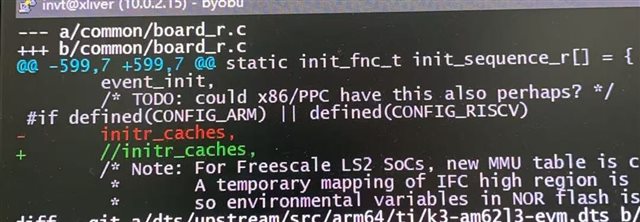

Referred this post to patch UBOOT to support DDR4.
https://e2e.ti.com/support/processors-group/processors/f/processors-forum/1482140/sk-am62-am62l-boot-problems-ddr-configuration
But can run through with inintr_cahes, if keep it, code will hang, if comment out it, it can run through.
Customer use very early sample AM62L device, is it related to AM62L device or their board design?
