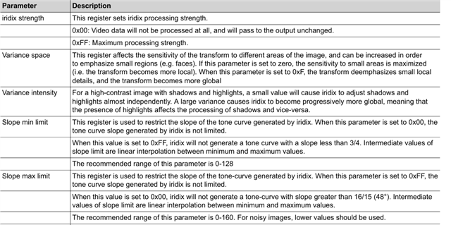

    Flickering could happen for different reasons.
    The issue we are discussing should be related to AE adjustment step size and local tone mapping (GLBCE) context.
    GLBCE has one frame of delay for statistics context collection and application.
    In general, AE should use small step size so that it does not go into racing condition with GLBCE

    I then check the GLBCE function in our IMX728 tuning parameters (IMX728_viss_glbce.xml) by your previous suggestion.
    Our current GLBCE setting are as follows (the flicker exists during brightness change):
    <viss_glbce_dcc type="viss_glbce">
                    255, //strength
                    12,  //intensity_var
                    7,   //space_var
                    64,  //slope_min_lim
                    72,  //slope_max_lim
                    1,
                    {    //fwd_prcpt_lut
                        0, 4622, 8653, 11684, 14195, 16380, 18335, 20118, 21766, 23304,
                        24751, 26119, 27422, 28665, 29857, 31003, 32108, 33176, 34209, 35211,
                        36185, 37132, 38055, 38955, 39834, 40693, 41533, 42355, 43161, 43951,
                        44727, 45488, 46236, 46971, 47694, 48405, 49106, 49795, 50475, 51145,
                        51805, 52456, 53099, 53733, 54360, 54978, 55589, 56193, 56789, 57379,
                        57963, 58539, 59110, 59675, 60234, 60787, 61335, 61877, 62414, 62946,
                        63473, 63996, 64513, 65026, 65535,
                    1,
                    {    //rev_prcpt_lut
                        0, 228, 455, 683, 910, 1138, 1369, 1628, 1912, 2221,
                        2556, 2916, 3304, 3717, 4158, 4626, 5122, 5645, 6197, 6777,
                        7386, 8024, 8691, 9387, 10113, 10869, 11654, 12471, 13317, 14194,
                        15103, 16042, 17012, 18014, 19048, 20113, 21210, 22340, 23501, 24696,
                        25922, 27182, 28475, 29800, 31159, 32552, 33977, 35437, 36930, 38458,
                        40019, 41615, 43245, 44910, 46609, 48343, 50112, 51916, 53755, 55630,
                        57539, 59485, 61466, 63482, 65535
                    {    //asym_lut
    				  #include "asym_lut.txt"
                </viss_glbce_dcc>
    Then I set strength from 255 to 0, the preview seems darker but no flicker phenomenon during brightness change.
    So I would like to check whether the cause is from GLBCE.
    But the document (VPAC3_CFA_WDR_plugin_guide.pdf) in DCC tool has not much explanation about GLBCE tuning parameters.
    Is there other guide for us to do some GLBCE adjustment?
    Thanks a lot!
  • Hi Steven,
    This disables GLBCE.
    GLBCE is part of the problem for sure as we discussed previously.
    We have to limit AE step size such that AE and GLBCE won't get into a racing condition.
    That is included in the TRM.

  • Hi Gang Hua,
    Thanks for reply !
    We have a TRM document "SPRUJ52B - J782S4 Technical Reference Manual.pdf".
    The chapter 6.7.3.5.5 states that GLBCE generates statistic base on frame N and then apply to frame N+1.
    To my understanding, if brightness change is huge between frame N and N+1 (e.g. when the car is entering or exiting a tunnel), the GLBCE may not well suit for frame N+1 due to GLBCE algorithm design has one frame delay to apply, is that correct ?
    If so, since our application is for ADAS use,
    while minimizing changes to AE step size as much as possible (to maintain AE converge speed),
    is there any related GLBCE parameters to alleviate or even eliminate the flicker problem ?
    Or is there one way to decrease AE step sizes a little bit plus some modification of GLBCE to reach my purpose ?
    Steven
  • Hi Steven,
    Yes, it is about the difference between the frames and continuity.
    There is a racing condition between AE and GLBCE.
    Both may brighten the image at the same time at frame N, which makes frame N brighter than expected.
    If there only a one large exposure change at frame N (no more changes after), frame N+1 will be darker and frame N is an overshoot (flickering).
    So, we would like to change exposure in smaller steps to mitigate the flickering.
    Practically, exposure change is gradual compare to sensor frame rate (never a single frame change).
    I don't know all the details about final applications, but many ADAS customers adjust AE step sizes and frame rate so that AE speed is fast enough for possible road conditions.
