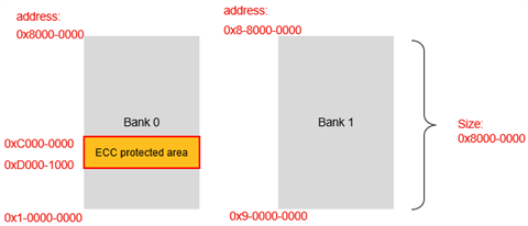

My workaround solution is that, after system bootup,  disable ECC interrupt before initial write ECC protected area, then resume ECC interrupt after initial write.
Then I do below experiment in SDK ti-processor-sdk-linux-adas-j721e-evm-10_01_00_04
in R5 u-boot stage,
  • add ti,ecc-enable = "true" and ss_cfg register range into k3-j721e-ddr.dtsi to enable in-line ECC function in MSMC2DDR bridge
  • configure ECC protected area 0xC000-0000 ~ 0xD000-1000
  • then initial write DRAM area    0xC000-0000 ~ 0xD000-0000  with specific patten 0x12345678deadbeef
  • that is to say, 0xD000-0000 ~ 0xD000-1000 is ECC protected, but not initial written.
in A72 u-boot stage,

    R5 u-boot dram host driver, config ecc protect area and initial part of it
    file: ti-processor-sdk-linux-adas-j721e-evm-10_01_00_04/board-support/ti-u-boot-2024.04+git/drivers/ram/k3-ddrss/k3-ddrss.c
    static void k3_ddrss_lpddr4_ecc_init(struct k3_ddrss_desc *ddrss)
        k3_ddrss_set_ecc_range_r0(base, 0x40000000, 0x10001000);  // ECC protected DRAM area
                                                                                                     // mapping to 0xC000-0000, +0x1000-1000
        k3_ddrss_preload_ecc_mem_region( (u64 *)0xC0000000, 0x10000000, 0x12345678deadbeef);
                                                                                                     // initial write DRAM area 0xC000-0000, +0x1000-0000
                                                                                                     // postpone 0x1000 DRAM area initial write to A72 u-boot
                                                                                                     // But unexpected error occurs even ECC interrupt disabled
    I want to check if this "delayed initial write" solution works in A72 u-boot.
    If ecc error handle flow is available and works in u-boot, then  I can apply it to Linux.
    Thanks for your support in advance !

    // 01. R5 u-boot config ECC protected area 0xD000-0000 ~ 0xD000-1000, but no initial write, ECC_CK disabled
    // 02. check ECC protected area content before initial write, no ECC error as expected due to ECC_CK disabled

    Note ECC feature is available inside both MSM2DDR and DDR controller, but only one can be enabled.
    In ti-processor-sdk-linux-adas-j721e-evm-10_01_00_04, seems that only MSM2DDR ECC driver is available in R5-uboot.
    Do you suggest use DDR controller ECC feature?  any u-boot patch available ?
    Thanks.

    The DRAM falls into the range: 0x80000000 to 0x900000000. Can you run tests with setting the memory within this range?
    Another note, looking at the memory the BIST would set, the range is 0xe0000000 (8/9 * 0x100000000).
    The errors that you are encountering are likely due to you trying to access inaccessible system registers.

    Let's focus on my 1st post test sequence, the test area fall into bank-0 range:
