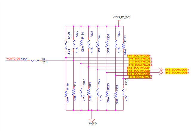

We’ve developed a custom TDA4 board currently booting from the SD card.
In our design:
  • eMMC is connected to port 0
  • SD card is connected to port 1
For SD card booting, the boot mode configuration is set as follows and is working correctly:
  • MCU_BOOTMODE [9:0] = 0000000000
  • SYS_BOOTMODE [7:0] = 01101011 ( PFA image for it )
Now, we want to switch to booting primarily from eMMC, with the SD card as a fallback.

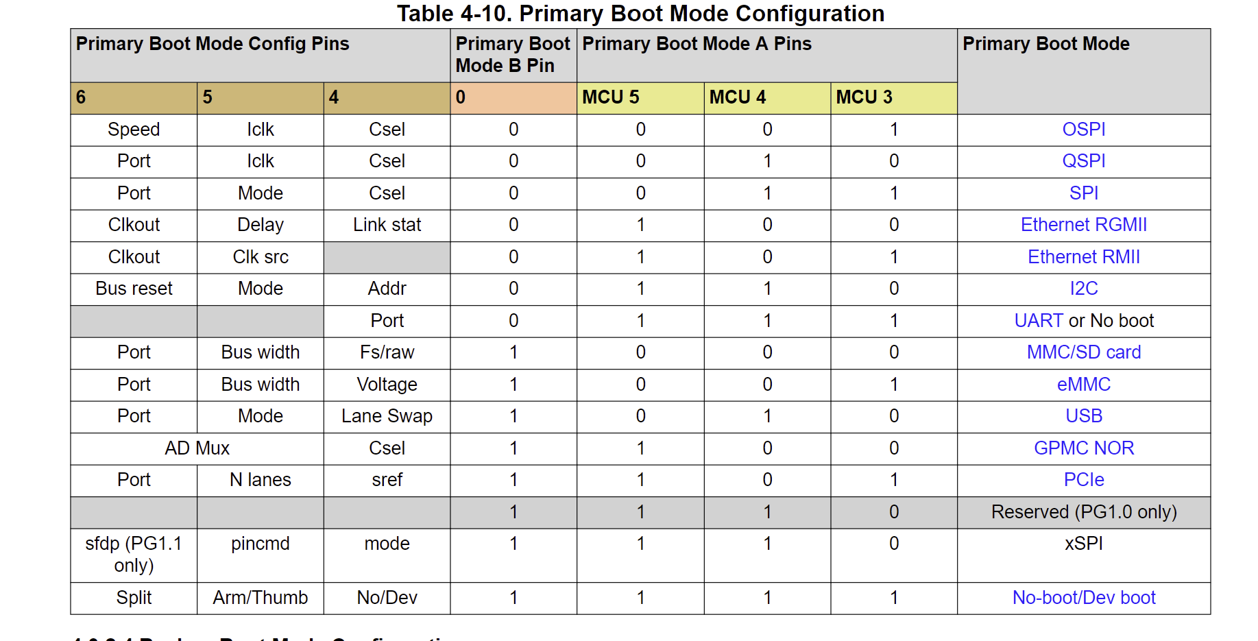

According to the TDA4VM Processor TRM, we updated the boot configuration to:
  • ONLY = 0 (Normal boot mode)
  • MCU_BOOTMODE [9:0] = 0000001000
  • SYS_BOOTMODE [7:0] = 10001011
However, with this configuration, the board is not booting from eMMC as expected.
We've implemented the required pull-up and pull-down resistors, but something still seems to be off.
Could someone please help identify what might be wrong with our configuration?
