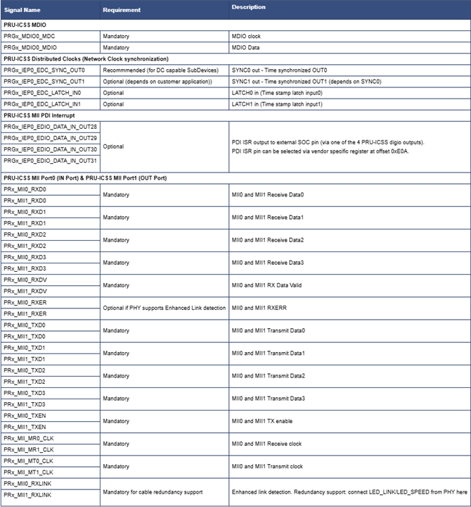

Then I share 3 sysconfig files: (1) sysconfig with pcie configuration, (2) sysconfig with ethercat configuration and (3) sysconfig with ethercat and pcie configuration.
We are limited to the version of the sysconfig tool, this is 1.14.0+2667.
Any suggestions why ethercat doesn't work with merged sysconfig?

  • Hi Joao,
    Could you give more details on the error you're seeing? When you say, "technology does not start correctly", do you mean you're not able to scan for the EtherCAT SubDevice using EtherCAT MainDevices or is it like the application build is failing or hitting an assert?
    A couple of things to check on:
    1. Since its sysconfig changes, you can just monitor 0x30090000 Register to see if the firmware is loaded correctly. This register will provide the EtherCAT FW version.
    2.  Make sure the application is running without any asserts. This can be confirmed by pausing the R5F core at multiple instances and see if it is running and not stuck at a particular space.
    3. Make sure the EtherCAT pins are mapped correctly in sysconfig and no mandatory signals are left out.
    Aaron
