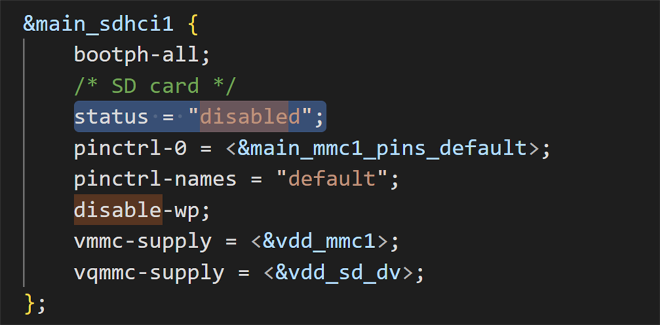

Hi Team,

  • Hi user,
    Sorry for the late reply.
    I would like to implement a function to switch between enabling and disabling main_sdhci1.
    You can enable or disable sdhci1 by adding the status=disabled in the corresponding device tree of the board which you are using.
    I am attaching a sample example below as well for reference.
    Gokul
    thank you for your reply.
    I'm sorry for not clearly stating the prerequisites.
    I want to switch it enable and disable without changing the fitImage.
    USB can be enabled and disabled in the terminal, is it possible to do something similar with main_sdhci1?
    regards
    mizutani
