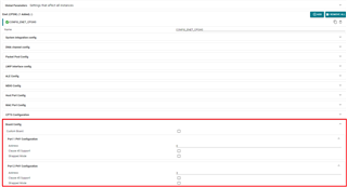

  • Hi Cyril,
    Thank you for the detailed explanation.
    According to information provided by the ENET CPSW team - in SDK version 09.02, PHY configuration is performed through the "Board Config" section of the ENET (CPSW) SysConfig instance. Please refer to the attached screenshot for reference.
