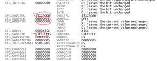

RTI_WWDRXNCTRL Register (0x406000A4) is 05H, watchdog timeout action is reset the system
RTI_WDSTATUS Register (Offset = 98h) [reset = 0h] is 0x3A now, indicates that there are watchdog timeout, and multiple watchdog violation events happened. The system should reset with this status, but board is NOT reset; it keeps looping there.

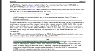

    Does this issue happen at a specific time in your application? Such as during boot? During boot up, DMSC will use MCU_RTI0 watchdog timer, as specified below, to perform WDT reset if the TIFS image is not loaded within the allotted 3 minutes.

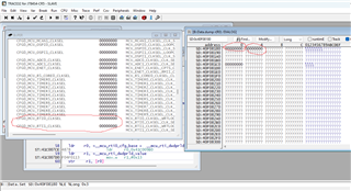

  • One issue I found is: I can not change the RTI clock from mcu_ctrl_mmr_cfg0 registers. My program can not configure the clock, and I tried changeing the clock source from debugger like below, it does not allow me to write.  Any special steps to make  mcu_ctrl_mmr_cfg0 registers writable ?  Is address translation needed to configure the clock? I noticed that TI example is also doing direct register writing

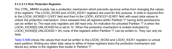

    Can you confirm whether you are unlocking the KICK protection registers when accessing this register space? Please take a look at the following snippets from the TRM:

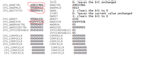

    3: configure the mcu_rti0 watchdog from debugger manually
        a: write 0x13 to address 0x40600094
        b: write 0xff to address 0x40600098 to clear the watchdog status
        c: write 0xA98559DA 0x40600090 to start the watchdog
    run the program again, and see if the reset action is triggered by watchdog or not

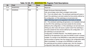

    From J721E reigisters description, watchdog reset -s not supported ? Can you confirm if watchdog reset is suppoted by J784S4 ?
