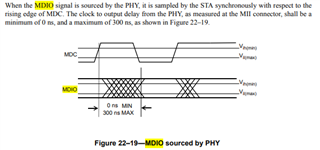

    Quote from IEEE802.3 documentation.
    Case of Read (From viewpoint of MAC)
    When the MDIO signal is sourced by the PHY, it is sampled by the STA synchronously with respect to the rising edge of MDC.
    Case of write (From viewpoint of MAC)
    When the STA sources the MDIO signal, the STA shall provide a minimum of 10 ns of setup time and a minimum of 10 ns of hold time referenced to the rising edge of MDC

    I was referring to https://www.prodigytechno.com/protocols/mdio-management-data-input-output however after reviewing the actual IEEE 802.3 documentation, I think the information provided in this link is probably a wrong interpretation of the read MDIO operation.
    Looking closely at the standard itself: "When the MDIO signal is sourced by the PHY, it is sampled by the STA synchronously with respect to the rising edge of MDC. The clock to output delay from the PHY, as measured at the MII connector, shall be a minimum of 0 ns, and a maximum of 300 ns, as shown in Figure 22–19"
    And https://en.wikipedia.org/wiki/Management_Data_Input/Output indicated "When the PHY drives the MDIO line, the PHY has to provide the MDIO signal between 0 and 300 ns after the rising edge of the clock.[1] Hence, with a minimum clock period of 400 ns (2.5 MHz maximum clock rate) the MAC can safely sample MDIO during the second half of the low cycle of the clock."
    Based on this information, I believe that this means during a read MDIO operation, the MDIO sampled by the MAC should be done at the rising edge of clock.
