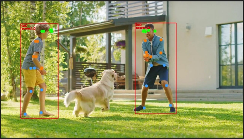

We are experiencing very poor detection results with the YOLOX pose model on the SK-AM68 board with Edge AI SDK 9.2, while the precompiled model performs well on a BeagleBoard with TDA4VM using Edge AI 8.2. The issue affects both TI’s precompiled model and self-compiled model (using edgeai-tidl-tools).
Issue Description
  • Setup:
    • AM68: SK-AM68, Edge AI 9.2, YOLOX pose (TI’s r9.2 modelzoo + self-compiled).
    • TDA4VM: BeagleBone AI-64, Edge AI 8.2, YOLOX pose (TI’s r8.2 modelzoo + self-compiled).
    • Identical input data.
    • Inference using edge-ai-apps / edgeai-gst-apps
  • Problem: On AM68, bboxes are inaccurate, with very low confidence scores, often people are completely undetected. Decresing confidence threshold reults in false positives, also pose estimation is inaccurate. TDA4VM performance is similar to original .pth model detection - see images below.
  • Experiments on AM68:
    • We tried experimenting with some compilation parameters like high_resolution, tensorbit, quantization_scale_type, and add_data_convert_ops, but detection results remained very poor.
Image comparison:
yolox_s on AM68
yolox_s on TDA4VM
We would very much appreciate your help in resolving this issue.

    1. The main issue is that the yolox-human-pose-s model, whether trained and compiled using edgeai-yolox and edgeai-tidl-tools, or downloaded precompiled from the model zoo, shows:
    • Good detection accuracy on BeagleBoard BBAI-64 (TDA4VM) with SDK 8.2 and on SK-AM68 with SDK 8.6.
    • Poor detection accuracy on SK-AM68 (AM68A) with SDK 9.2 and 10.1.
    1. This applies to models trained on both COCO keypoint dataset and a custom dataset.
    2. By "poor detection," we mean that:
    • Persons (or objects in the case of the custom dataset) are sometimes not detected at all.
    • In other cases, detections are inaccurate — for example, bounding boxes do not fully enclose the person, false negatives and false positives, and keypoints can be incorrectly placed, as shown in the image above.
    • Here's a video of detections on both boards:
    Human pose model on AM68A with edgeai gst-apps 9.2:
    Human pose model on beagleboard with TDA4VM with edgeai apps 8.2:

  • Hi Peter;
    I had setup the AM68 and ran the YOLO pose detection with the same model you are using. I comfirm your results
    For the version 10.1 when I set the viz-threshold = 0.3. the bounding box is more stable. Please see the first video clip. (viz=0.3)
    Yes, the version 8.6. is more stable/accurate. Please to refer to the 2nd version. But 10.1 has the red frame indication feature.
    Please take a look, we can discuss them later.
    Best regards
    https://e2e.ti.com/cfs-file/__key/communityserver-discussions-components-files/791/output_5F00_video0_5F00_viz0p3.mkv
    https://e2e.ti.com/cfs-file/__key/communityserver-discussions-components-files/791/output_5F00_video0_5F00_8_5F00_6_5F00_short.mkv

  • Hi Hans Peter,
    We have root caused this issue to preprocessing module.
    Please use attached module to /opt/edgeai-tiovx-modules to fix the issue
    https://e2e.ti.com/cfs-file/__key/communityserver-discussions-components-files/791/0001_2D00_tiovx_5F00_dl_5F00_pre_5F00_proc_5F00_module_2D00_Use_2D00_DSP_2D00_kernel_2D00_instead_2D00_of_2D00_A.patch
    Rahul T R
  • Hey Rahul,
    I wonder why you nail the 'target_type' string in line 369 fix to TIVX_TARGET_DSP1, making the method parameter 'target_string' completely obsolete. That let me assume that the fix is only temporary? Additionally, the duplicate module over at edgeai-tiovx-apps:modules also creates a node of type 'tivxDLPreProcArmv8Node', does that mean an additional fix is needed there?
    Overall, can you explain a little more in detail why this is an issue that was introduced in later SDK versions than 8.6? Commit b283ab53d7f77355e56835c1e01b2d73255a08ff introduces the change to Armv8 as a bugfix without further explanation, could you please explain why you revert it again, what the initial reason/bug was that it should have fixed and so on... In general, it would be great to have a more coherent path for the user to choose a branch for downstream development, so commit messages with more explanation would be a start.
    Steffen
  • Hi Steffen,
    Sorry for not explaining more about the fix
    Here are the details
    During 9.0 we had moved pre proc kernels from DSP to Arm neon for better scalability.
    Seems like some bug in Arm neon pre proc module, which is reducing the DL input quality.
    As a temporary solution I have given patch to edgeai-tiovx-modules to use DSP version of the
    pre proc kernel. We will work on fixing the ARM neon kernel in upcoming release
    This is temporary solution to rule out issues with TIDL model
    Rahul T R
