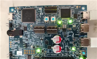

  • Hi, Nick
    It is a TI EVM board
    And i have change switch to eMMC boot mode
    Meng
  • Hello Meng,
    Please update boot switches
    Your boot switches do not look correct to me. Please set them to match the "EMMC BOOT MODE" graphic here:
    https://software-dl.ti.com/mcu-plus-sdk/esd/AM62AX/10_01_00_33/exports/docs/api_guide_am62ax/EVM_SETUP_PAGE.html#BOOTMODE_EMMC
    Looks like there is a bug in the EVM User's Guide
    It looks like there is a bug in the Bootmode section of the AM62A Low-Power SK EVM User's Guide, table
    "Table 4-15. Primary Boot Media Configuration BOOTMODE [9:7]". I think this table should have a bunch of ON/OFF information, not all the random text that is there in revision A of the document.
    I have filed a bug against the document. Apologies for any confusion here.
    Nick
  • Hello Nick,
    I set the Switch to EMMC boot mode according to the documentation,
    but it still has the same error as before,
    and when I manually execute these commands,
    setenv mmcdev 0
    setenv bootpart 0
    boot
    It can enter the system successfully,But I hope it can successfully enter the system by itself.
    Meng
  • Hello Meng,
    When you are booting with EMMC, do you still have an SD card plugged in? If not, what happens when you remove the SD card? Are you still able to get to uboot?
    Nick
