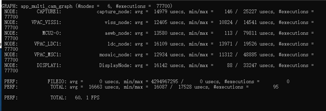

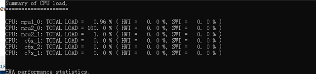

  • Hi,Gang
           I tested the load capacity of R5 core and set the sensor setting to 60fps. When aewbObj ->params When awb. num_stkip_frames/aewbObj ->params. aw_ num_stkip_frames is set to 0, the actual frame rate is 30fps, and the load of R5 core is 100%.
           When aewbObj ->params When awb. num_stkip_frames/aewbObj ->params. aw_num_stkip_frames is set to 4, the actual frame rate is 60fps, and the load of R5 core is over 90. However, when performing AE algorithm, the load of R5 core becomes 100%, and the frame rate is 57fps
    May I ask how to solve this problem?
  • Hi enrui,
    Thanks  for the confirmation!
    It looks like R5 is overloaded.
    Please also confirm who are using most of the R5.
    AWB has some heavy computation (much more than AE).
    Therefore, we cannot run AWB at a high frame rate with too many cameras.

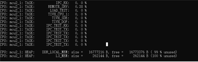

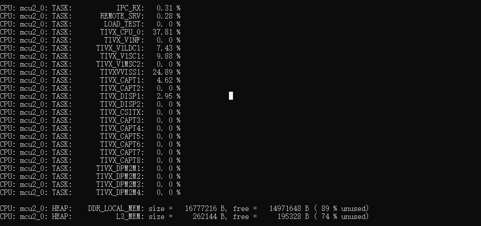

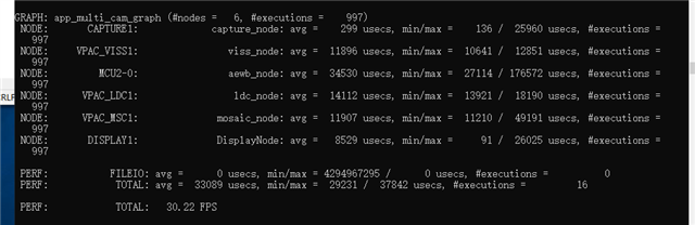

  • Hi Gang
    1. The following figure shows the specific usage of R5 core
    2.Regarding the issue of frame reduction, I did not see any improvement after reducing H3A Windows
    3.I added a synchronization trigger function and changed the frame rate from 60fps to 50fps, which solved the problem of frame reduction

  • Hi enrui,
    Is AWB included in task TIVX_CPU_0?
    In this case, do you still see 100% loading on R5?

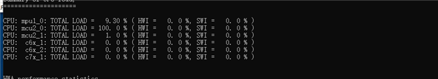

  • Hi Gang
    1. I think AWB is in TIVX_CPU-0
    2. In this case, the R5 core is still 100%
    3. The issue of splicing delay has been resolved, but whether it is 30fps or 50fps, when clicking on four modules at the same time, if the skip is too low, frame drop will occur. When the skip is set to 0, R5's load is 100%. How to solve the frame drop problem? Can the AE/AWB algorithm be run on MCU2_1? Will this solve the frame drop problem?
  • Hi enrui,
    The picture above showed ~90% loading already.
    What is TIVX_VVISS1 (24.89%) for?
    I suppose R5 cannot be close to 100% loading.
    If that happens, frame dropping is likely.
