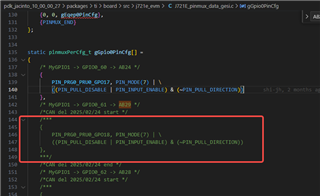

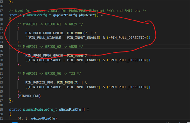

We configured AB29 as mode 7 on mcu1_0, but if mcu2_0 turns on ethfw, AB29 will probably be changed to mode 0.
I found configuration AB29 here and deleted it, but the above phenomenon still occurs.

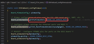

Where does ethfw configure the pinmux for AB29?
