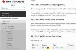

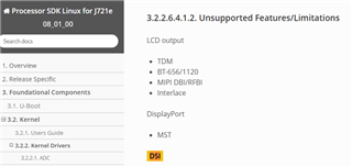

Because of some reason, customer use SDK 8.1 w/ mass production for a long time, but they have new requirement for DSI support on SDK 8.1
As far as we know, SDK 8.1 do not support DSI, nut SDK 10.1 already does
How to patch SDK 8.1 support DSI?

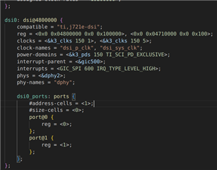

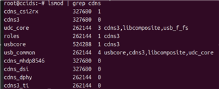

Device tree:
kernel module probe is fine for cdns_dsi and cdns_dphy,
but cdns_dsi_attach and cdns_dsi_bridge_attach never execution.
What kind of state will trigger  cdns_dsi_attach or cdns_dsi_bridge_attach?

  • Hi Gibbs,
    I understand that it will be effort on customer end to port code to newer SDK, and there will be customers that do not want to move since they are in production or nearing production.
    However, in general, our team does not support backporting to old SDK. Our recommendation is to move to the latest SDK, since it has the latest bug fixes and newest features. 8.1 SDK is 3+ years old, so there has been quite some re-architecture of the display related code within Linux.
    Therefore, if customer wants to continue on the old SDK, support from TI will unfortunately be limited.
