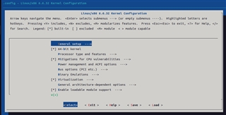

  • Hi Takuma
    I have opened the cross compile for arm64, and find the CONFIG_DRM_PANEL_SIMPLE configuration
    It depend the DRM configuration
    but DRM in turn depends on AGP
    However, I can't find the configuration for AGP under Graphics support.
    Could you please tell me where the AGP configuration is located?
    FuGuojia
  • Hi FuGuojia,
    Your screenshot looks to show AGP configuration is located... but I do not think AGP is required for DRM. Kernel config says (AGP [=n] || AGP [=n] =n).
    In any case, I will like to point out that your device driver is not complete. It is missing essential Linux code like drm_bridge_add() to register the bridge, and functionality to connect between DSI port and panel port. It is possible to use the driver in a non-standard way, since you seem to have the device specific I2C writes to configure the bridge, but I do not think you are intentionally going down this non-standard path as it requires good knowledge of both Linux and how the device works.
    Again, I recommend going through the free training that I have linked previously, or paying a Linux expert to create the driver, or pay to get consulting/training.
    Takuma

  • Hi FuGuojia,
    CONFIG_DRM=m means it is enabled as a kernel module. This is fine.
    The reason why your display pipeline is not working is because there are issues with your driver for the bridge. As stated before, it is missing vital functionality to connect to DSI and display panel, and it does not register itself to the DRM framework. This is not something fixable with kernel configuration changes. There are other reasons like devicetree not being configured correctly, but that depends on driver issues to be resolved.
