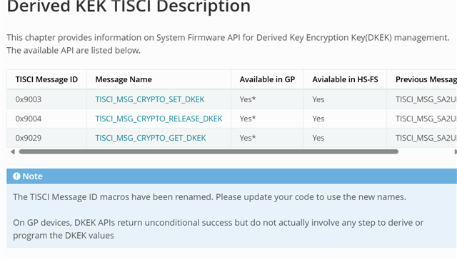

    1. Why does OP-TEE 4.4 in SDK 10.1 still use the older TI_SCI_MSG_SA2UL_GET_DKEK (0x9029) instead of the newer TISCI_MSG_CRYPTO_GET_DKEK (also 0x9029) for DKEK retrieval?
    2. is it sufficient to modify OP-TEE to use TISCI_MSG_SA2UL_GET_DKEK_CONST instead of TI_SCI_MSG_SA2UL_GET_DKEK(in fuction ti_sci_get_dkek)
    3. Functional Differences:
    • What are the differences between the old and new DKEK APIs?What advantages does the new DKEK ?Are there drawbacks to the old DKEK ?
    • Can dual-DKEK verification (If the new dkek verification fails, use the old dkek) be implemented for backward compatibility?
    On #1, they are the same APIs, No difference in behavior, The API was renamed to make the service name generic. We kept the old name also to not break any compatibility.
    The rename of crypto related messages from SA2UL to CRYPTO was done to make the service generic without the crypto accelerator name in the message. We moved from SA2UL to DTHe for AM62L and plan to use same TISCI messages.
    TI_SCI_MSG_SA2UL_GET_DKEK == TISCI_MSG_CRYPTO_GET_DKEK
    Derived KEK TISCI Description — TISCI User Guide
    On #2, TISCI_MSG_SA2UL_GET_DKEK_CONST was a temporary  solution for customers who already used the previous API.
    On #3 a) We recommend and encourage to move to the latest API and SDK 10.1
    On #3 b) can you clarify further on why you need this? Do you have units deployed in field etc?

  • Hi Xiaohui,
    The two legacy DKEK APIs in Linux SDK 8.x (+early ones) should not be used in any system due to the DKEK security issue.
    a/. For the system deployed with Linux SDK 8.x (+ early ones), system update is needed as noted in my first reply.
    - Upgrade to the latest TIFS (TIFS 9.2.7 or newer)
    - Use the two APIs (B) to get the old “constant” DKEK, and the HUK for OPTEE secure storage operations (i.e. decryption)
    (TISCI_MSG_SA2UL_SET_DKEK_CONST/TISCI_MSG_SA2UL_GET_DKEK_CONST)
    - Use the two DKEK APIs (A) to get the correct DKEK, and HUK for OPTEE secure storage operations (i.e. re-encryption)
    (TISCI_MSG_SA2UL_SET_DKEK/TISCI_MSG_SA2UL_GET_DKEK)
    b/. For the new system with SDK 9.x or newer (TIFS 9.2.7 or newer),
