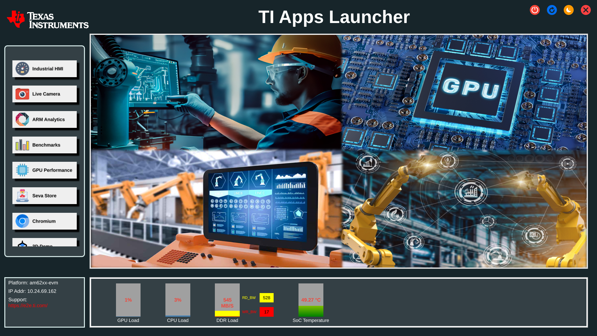

We also incorporate this in some of out demos example
QT OOB which uses perf_stats.cpp underneath - https://texasinstruments.github.io/processor-sdk-doc/processor-sdk-linux-AM62X/esd/docs/11_00_09_04/_images/ti-apps-launcher-home-am62x.png
