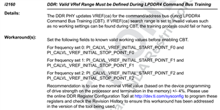

  • Hi Maurice, the start and stop points are in the MSBs of the register you show:   0x321E3200
    Red is stop point, Green is start point. Note these are calculated based on the driver and ODT settings for CA.  Why do you need to change them?  We have an errata item which restricts this range (this is why it is being calculated), otherwise the CA training algorithm may hang.

  • Hi Maurice, the errata will show up in next versions of errata docs.  For now, here is a preliminary version:
    What do you mean by CA to CLK training range?  Do you mean the slave delays to help align CA to CLK?  There aren't any adjustable registers for this function.  The training process will perform a per-bit deskew across a 300ps delta to for the addr/ctrl as well as data busses.
