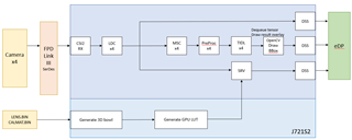

Hi TI experts,
We have developed a custom vision application that performs object detection and surround view simultaneously on TDA4VE in Linux + RTOS mode. (using SDK r10.1)
However, the system occasionally freezes under heavy load.
The application may run normally for several hours before freezing.

Once a freeze occurs, the UART disconnects and becomes unresponsive, JTAG cannot connect, and the power LEDs for the main and mcu domain (LD5 and LD6) turn off.
There are no messages indicating segmentation faults, kernel crashes, or application errors/warnings on the console before the system freezes, except for the following:

[26852.389441] tps6594 0-0048: Error IRQ trap reach ilim, overcurrent for BUCK1
Could you please guide us on how to further debug this issue?

    I dont see any reason in the above log, because of which the system could stop working.. I think the PMIC error "[26852.389441] tps6594 0-0048: Error IRQ trap reach ilim, overcurrent for BUCK1" would have seen earlier, isn't it?
    Most likely there is some corruption or some invalid access which causes entire system to stop.. So we will need more details.
    - How easy it is to reproduce this issue?
    - what is customer vision application? what all components does it include?
    - What is the dataflow?
    - For how long does it run fine?

    Yes, the PMIC error "[26852.389441] tps6594 0-0048: Error IRQ trap reach ilim, overcurrent for BUCK1" would have seen earlier before system (also UART) freezes.
    For your question, please see the answers below:
    1. This problem is not easy to reproduce, and the application may run normally for several hours to several days.
    2. The customer vision application runs object detection (TIDL: yolov5s 640x416) and surround view simultaneously, display uses three pipe for different layer, please see the graph architecture :

    3. Data flow is as below:
    4. As mentioned in the first point, sometimes it can run normally for several days, while other times it freezes after just a few hours.
    Thanks.

    1. Add srv graph in tidl_od_cam application, which called tidl_od_cam_srv
    2.Just run the graph without any additional processing
    3. run tidll_od_cam_srv with stress-ng
    Under the above conditions, the system froze after several hours of execution.
    Therefore, we suspect that the issue is caused by the high system load. If we remove nodes to reduce the load, the problem might not reoccur."
    Because the system froze, neither UART nor JTAG responded, and the LD5/6 indicators turned off. Is there any way to preliminarily determine whether it is a software or hardware issue? For example, could our EVM be damaged?
    And, if the error message from the PMIC indicates that the system might reset later?
