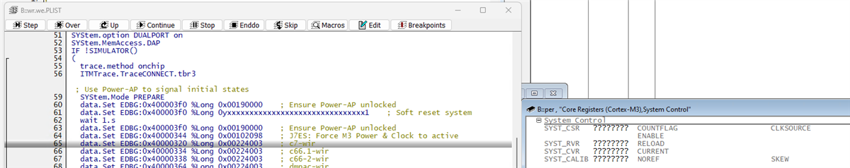

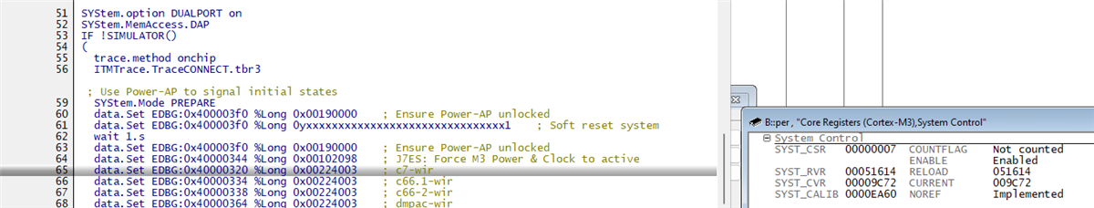

Regarding our custom board, flashing using UNIFLASH works fine, and we are able to boot. However, flashing using T32 fails. My guess is that due to the locked M3 JTAG on the HS version, there is no option to set clocks via the j7es_m3.cmm script, which is required for bare-metal flashing.
Evalboard registers visible and changing
(EVM board with GP: When forcing M3 Power & clock, active registers are visible and changing.)
HS custom board
(Custom board with HS: After forcing, register values go from 0x23000000 to ???)
Based on these observations, is it possible to flash the HS version using T32? Does this process require unlocking the JTAG for M3, or is there another solution to address the non bare-metal flashing issue?

     Have you tried unlocking JTAG before flashing to see if it works?
    For HS device, for JTAG access, you will need to unlock the JTAG. But I will confirm once on my end as well if this is something required with T32.
    Tanmay
  • Hi
    I am relatively new to security-related topics and have not yet attempted to unlock JTAG for the M3. Recently, I came across a post stating,
    "The M3 core on J7ES HS devices cannot be unlocked in a functional boot mode." TDA4VM: secure jtag (lauterbach)
    We have been successfully flashing the EVM GP board in OSPI boot mode and want to replicate this process on the HS board so switching to non-boot mode -> unlocking M3 JTAG and flashing each time I think defeats the purpose of using T32 scripts for easier flashing.
    HS devices are not really supposed to be used with a debugger. T32 is meant to debug on GP devices and the binaries can then be used with HS devices. That is the default flow. The device is also less secure if debugger can be used with HS devices.

    -0-
    It is possible to burn on either a GP or HS device using the TRACE32 flasher.   The typical way to use the scripts is in a non-functional boot mode.  That would be "NO-BOOT" for GP (set via boot mode switches) or via on HS using 'WIR" mode which is set by driving EMU0=0 across a power on reset.   The current flashing script has a call out parameter which takes the parameter HS:FS or HS:SE.  When the device is an HS this parameter will be used to unlock the part to allow scripts to fully run.  On a GP device the parameter is not used as it run time can tell its not an HS.   If you have an SE device a certificate is needed to unlock the device but that is not needed for a GP.  The unlock script will attempt to use the debugger to overdrive the EMU0 pin to ensure a clean 'no boot' start startup.
    I've attached current J7ES scripts which work on GP or HS. The bundle is encrypted with passwd of "TRACE32"
    /cfs-file/__key/communityserver-discussions-components-files/791/1050.cmm_2D00_tda4_5F00_dra829.7z
    -1-
    If you skip the baremetal and just try and run from an initialized R5, it is your responsibility to ensure all the clocks and flash timings are proper!   The flashing code assumes a 'clean' initial state.  If some other code has programmed the flash controller registers these simple scripts will not comprehend that and the script likely will fail.   It is 'far' easier and safer to startup in a no-boot state (gp-noboot, hs-wir) as the flashing will always work.  It may or may not work depending on initial state from a booted mode.  Imagine if code set the RAT mappings to some other address space every write would be an abort or .... the script cannot undue any possible previous code execution.
