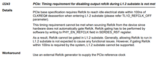

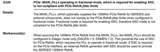

There are three errata for AM67x PCIe.
i.2242, i.2243 and i.2326
For i.2242, customer is wondering whether they can use clock source generate from AM67x if they claim support PCIe gen 2 only (not support Gen 3, 8Gbps). Customer will not use PCIe Gen 3 device either.
The purpose is not using external source clock for production to save cost.
For i.2243 and i.2326, one is for clock gating and another is for PCIe SSC support.
If not considering these two items, will we recommend adding external source clock for PCIe? (option 4 for i.2242)

    As for the erratas, I have not encountered the erratas personally when using some PCIe cards from well-known vendors, but I have seen customers in the past with FPGA or network switch seemingly encounter issues due to errata (although, we have not gotten confirmation whether the erratas were the cause of the issues).

    Therefore, i2242 will not be problem if not support 8GT/sec data rate (not support GEN 3).
    In this case, customer can keep using internal clock for production.
