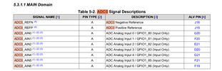

I’m working on the AM6442 EVM kit and would like to verify if the ADC0_AINx pins can be successfully converted into GPI (General Purpose Input) mode.
To configure all 8 ADC0 input pins (ADC0_AIN0 to ADC0_AIN7) to operate in GPI mode and read their digital output, I referred to the following thread and enabled the GPI mode using devmem2 for one pin (e.g., ADC0_AIN0) by writing to the CTRL_MMR register to select the GPI function.
https://e2e.ti.com/support/processors-group/processors/f/processors-forum/1499711/am6442-configuring-the-adc0-single-pin-as-gpi?tisearch=e2e-sitesearch&keymatch=ADC0%2520AIN0%2520as%2520input#
Steps I’ve Taken So Far:
  • I have configured the GPIO1 bank into the DTS, but I am unable to locate the pins (GPIO1_80 to GPIO1_87) that are listed in the datasheet.
  • Additionally, try using the devmem2 to read the register value for the pins, but a bus error occurred.

  • Hi Ankit,
    What is the best way to verify if all the ADC0_AINx pins are indeed operating in GPI mode on the AM6422x?
    Read the GPIO_DIR_XY register to know the direction of Pin(i.e. input/output).
    Do I need to explicitly configure GPIO1 in the device tree if I only want to read digital input status from the ADC0 pins via GPI mode?
    You can read the pin status by reading the GPIO_IN_DATA_XY register.
    As the ADC pins are tied to GPIO1_[80:87] which lies in the Bank 5. So the value for XY will be 45 for the above case.
