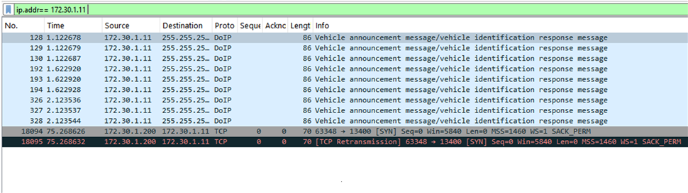

Now we are using the TCP prtocol provided by TDA2x.
Now TDA2x is TCP server

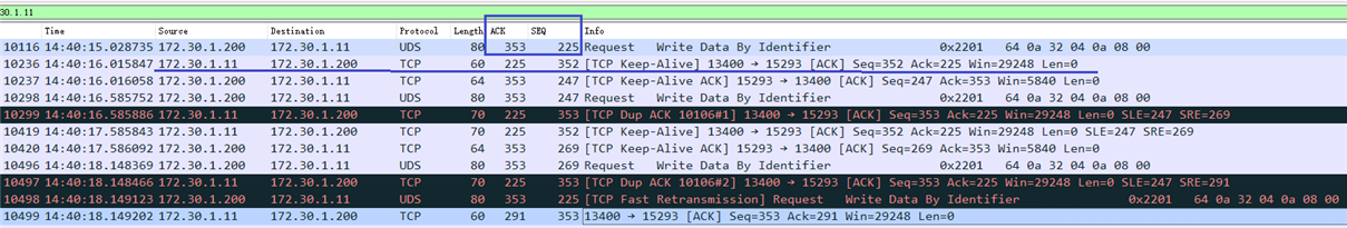

We met two strange issues. These two kinds of issue occured by accident.
1. When TCP client send SYN at TCP connection initilization stage, Server deos not response with SYN/ACK immediately.
2  ACK delay will be 1 second. Considering our test evnironment is based on cable, this delay value is too big.
Can you help to answer our questions?
