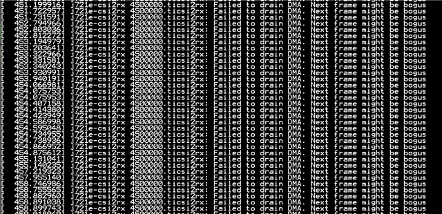

May I ask what causes this log to appear.
"Failed to drain DMA. Next frame might be bogus"
regards,
cesar

  • Hi Brijesh,
    Sometimes these logs are flashed after the system starts up
    regards,
    cesar

  • Hi Brijesh,
    sdk0900;
    example app cmd:
    gst-launch-1.0 -v \
    v4l2src device=/dev/video2 io-mode=4 do-timestamp=true ! queue max-size-buffers=240 max-size-time=0 ! \
    video/x-raw,format=UYVY,width=1920,height=1080,framerate=15/1,interlace-mode=progressive,colorimetry=bt709 ! \
    identity sync=true single-segment=true ! tiovxdlcolorconvert ! queue max-size-buffers=240 max-size-time=0 ! \
    video/x-raw,format=NV12,width=1920,height=1080,framerate=15/1,interlace-mode=progressive,colorimetry=bt709 ! \
    videorate ! video/x-raw,framerate=15/1 ! \
    v4l2h264enc extra-controls="controls, frame_level_rate_control_enable=(int)1, video_bitrate=(int)5000000, video_gop_size=(int)15;" ! \
    h264parse ! queue max-size-buffers=240 max-size-time=0 ! filesink sync=true location=/mnt/output/output${new_number}_2M_right.h264 &
    Under what circumstances will drain dma occur.
    regards,
    cesar
