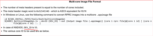

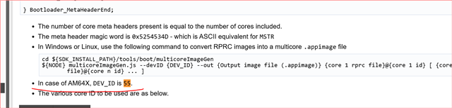

1.
I found devID is always 55, is that DEV_ID the fake one, actually, we can put into any number, right?
eg: in am243x it is 55
in am263x, it is still 55.
in am64x, it is another 55.
2. now, we both know that that dev_id is not used anywhere. Even it is part of  struct  Bootloader_MetaHeaderStart, instead, can I would rewrite it, and change the value to be reserved. Thanks.
