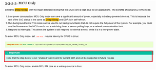

Reference this section, 3.3.5.5. MCU Only
https://software-dl.ti.com/processor-sdk-linux/esd/AM62X/11_00_09_04/exports/docs/linux/Foundational_Components/Power_Management/pm_low_power_modes.html
 Few question.
(1) Follow these test steps in MCU only MODE, MCU SS will keep working, and main core (A53, Linux) will go to sleep, is it right? (y/n)
(2) Because try to avoid linux resource table (RPMSG resource table) backup workaround, MCU only mode recommand accompany with FFI? (y/n)
(3) Can any GPIO wakeup main core (A53, Linux) in mcu onlyu mode?(y/n)
(4) We confuse this item,
Base on current SDK (v11.0), we do not support mcuss wakeup A53, is it right?(y/n)
Do we have any schedule to release this patch?
    Correct, for MCU Only mode, the MCU subsystem will remain online to run an application and use its peripherals.
    Can you explain what FFI means in this context?
    Yes.
    MCU Only does work. Please see the command directly above where you circled. The command for entering MCU only mode changed. That note is just to indicate that the old command doesn't work at this moment.
